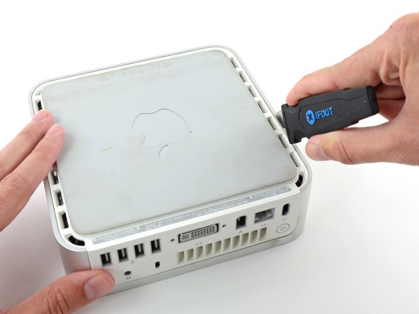

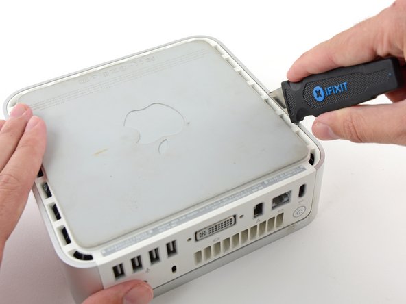

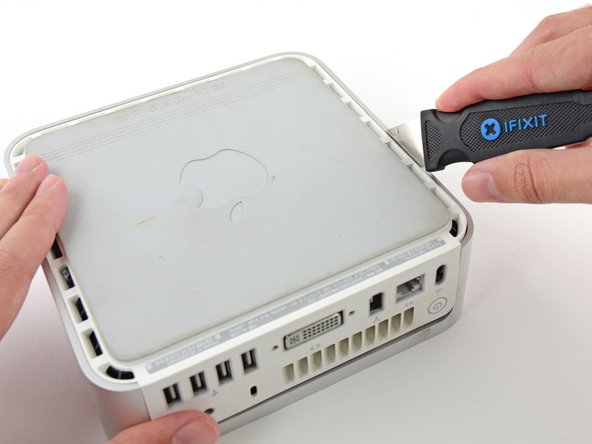

      • Power down your Mac mini, disconnect all of the cables, and flip it over.
      • Insert the Jimmy into the crack between the aluminum top housing and the plastic lower housing.
      • The Jimmy should reach a stop about 3/8" down.
      Ask FixBot
    2. Mac mini (PowerPC) Logic Board Replacement: step 2, image 1 of 3 Mac mini (PowerPC) Logic Board Replacement: step 2, image 2 of 3 Mac mini (PowerPC) Logic Board Replacement: step 2, image 3 of 3
      • Gently bend the Jimmy outwards to pry the crack open a little larger and lift the lower housing up a small amount.
      • There are several plastic clips on the lower housing that fit into a channel in the aluminum top housing. Your goal is to use the Jimmy to push these clips inward enough to free them from the channel, while gently pulling up on the lower housing.

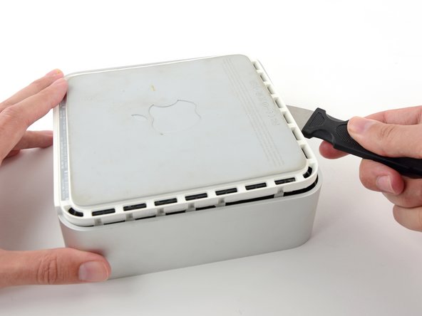

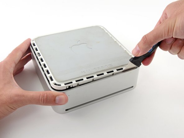

    3. Mac mini (PowerPC) Logic Board Replacement: step 3, image 1 of 2 Mac mini (PowerPC) Logic Board Replacement: step 3, image 2 of 2
      • Once you have the first side free, rotate the Mac mini and start prying up on the front edge.
      • Use the same prying motion to both bend the clips inward and lift the lower housing up out of the top housing.
      Ask FixBot
    4. Mac mini (PowerPC) Logic Board Replacement: step 4, image 1 of 2 Mac mini (PowerPC) Logic Board Replacement: step 4, image 2 of 2
      • You may need to move the Jimmy along the edge to pry up all of the clips. Be patient and do a little bit at a time.

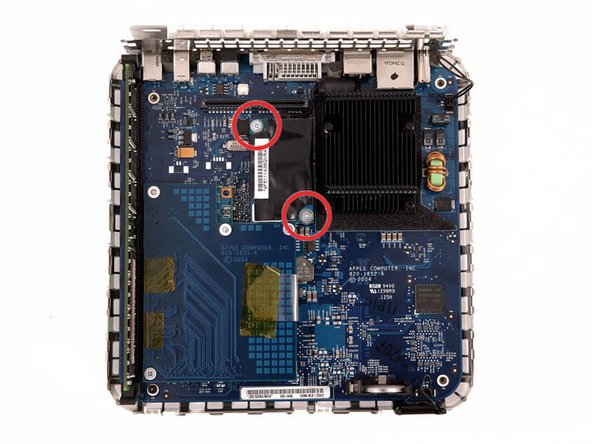

      • Remove the three black Phillips screws securing the plastic framework to the logic board and lower case.

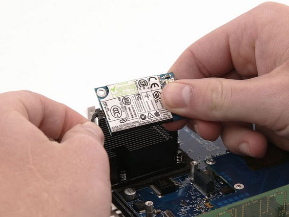

    1. Mac mini (PowerPC) Logic Board Replacement, Logic Board: step 15, image 1 of 1
      • Remove the two silver Phillips screws from the corners of the wireless interface board.
      Ask FixBot

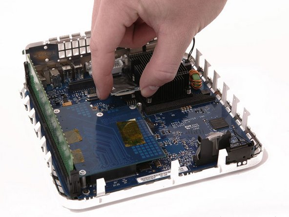

    2. Mac mini (PowerPC) Logic Board Replacement: step 16, image 1 of 1
      • Grasp the board at the front and back, and lift up on the front until the board pulls free of its connector.
      Ask FixBot

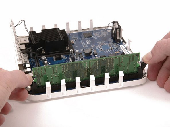

    3. Mac mini (PowerPC) Logic Board Replacement: step 17, image 1 of 1
      • Pull back the black plastic latches on either end of the RAM chip.
      Ask FixBot

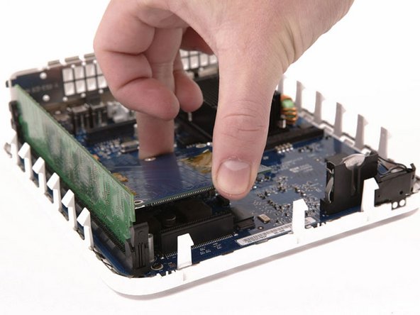

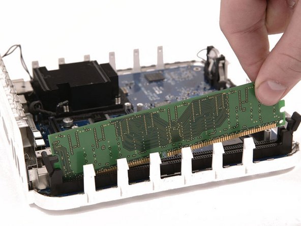

    4. Mac mini (PowerPC) Logic Board Replacement: step 18, image 1 of 1
      • Grasp the RAM chip at the end opposite of the back ports, and pull directly up.
      Ask FixBot

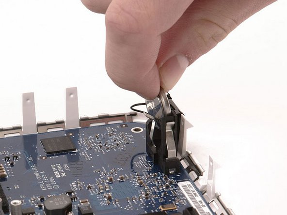

      • Push the PRAM battery in and pull it up. You'll have to push the battery in further than you'd expect in order to get it to pop free.
      • When inserting the new battery, make sure the side with writing along the edges faces the black plastic holder. You should also insure that the metal connectors make contact with the battery (you can bend them forward if they do not).

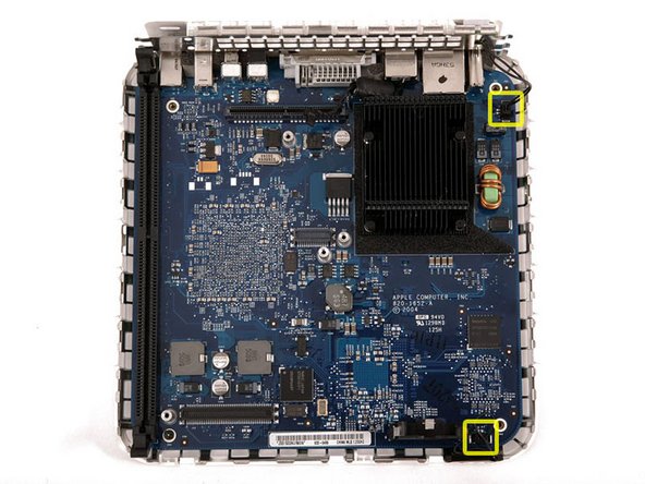

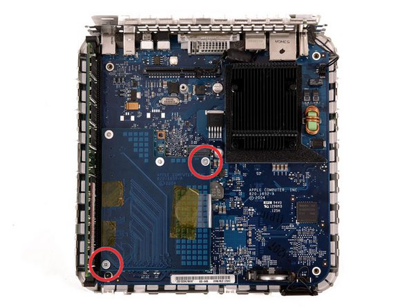

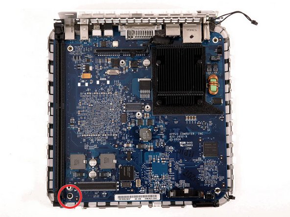

    7. Mac mini (PowerPC) Logic Board Replacement: step 21, image 1 of 1
      • Remove the single black Phillips screw from the front left corner of the logic board.
      Ask FixBot

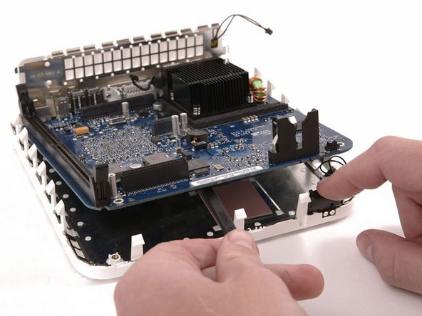

    8. Mac mini (PowerPC) Logic Board Replacement: step 22, image 1 of 1
      • Use one hand to slide a spudger underneath the logic board and the other to pull back on the black sleep light unit. Lift up the with the spudger to free the logic board from the lower case and use both hands to slide the logic board toward you.
      Ask FixBot
