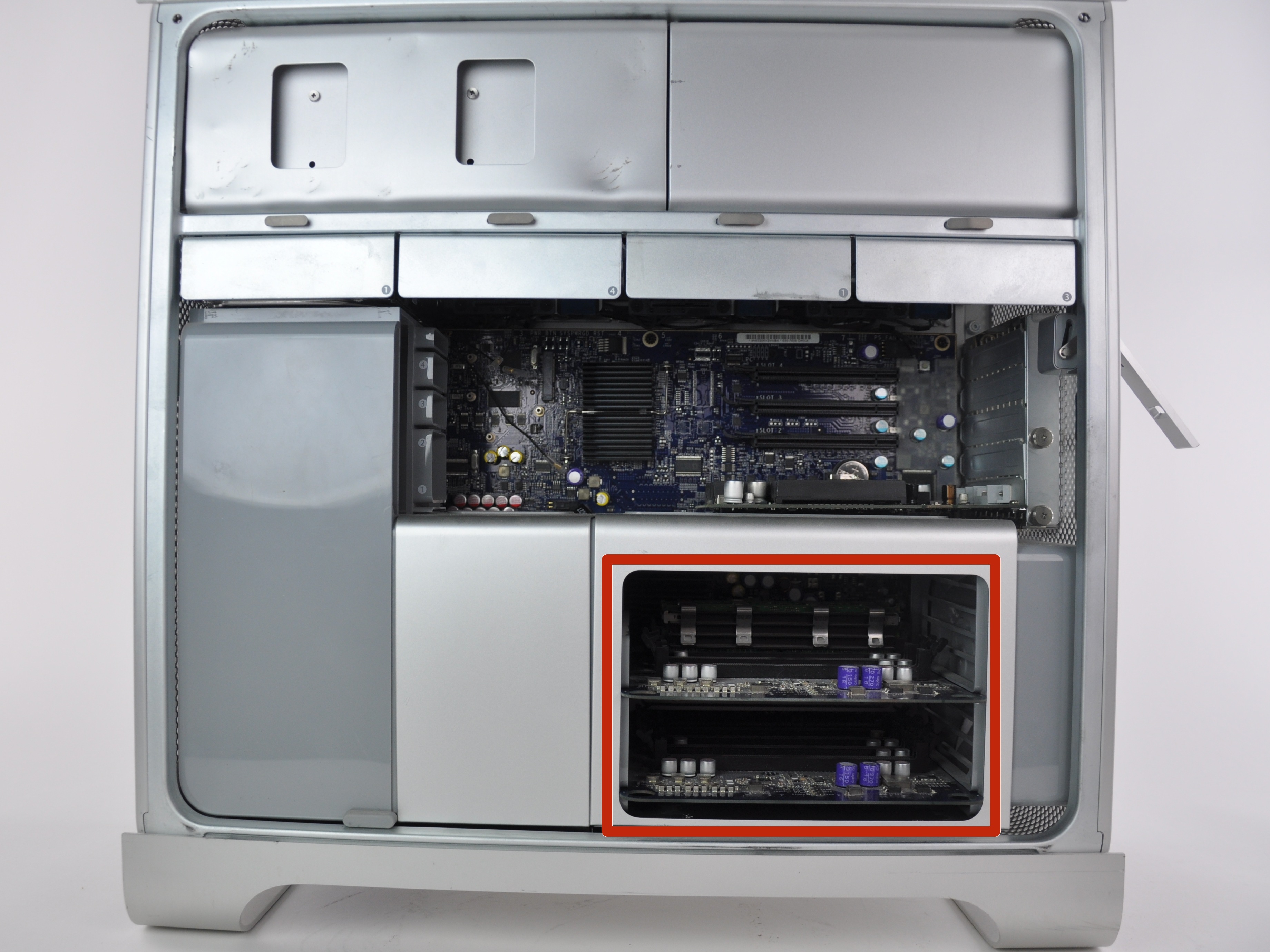

    1. Mac Pro First Generation RAM Replacement, RAM: step 3, image 1 of 1
      • Locate the two RAM trays at the bottom of the Mac Pro.
      Ask FixBot

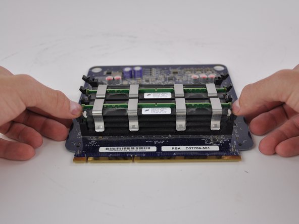

      • Pull the RAM tray out of the case by using both hands holding the edge of the ram board as shown.
      • Make sure you give enough time for the computer to cool down before you remove any internal hardware parts.
      Ask FixBot
    3. Mac Pro First Generation RAM Replacement: step 5, image 1 of 3 Mac Pro First Generation RAM Replacement: step 5, image 2 of 3 Mac Pro First Generation RAM Replacement: step 5, image 3 of 3
      • Push down on the ejectors on each side of a ram stick firmly and lift the RAM stick straight out carefully by holding each side.
      • To insert a new RAM stick, place the RAM into the slot with the correct orientation and push on the stick using both hands until the ejectors are clicked into place.
