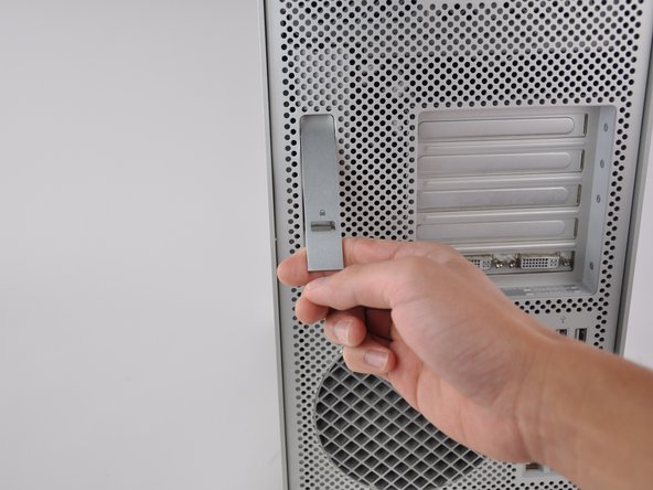

      • Lift the lever to unlock the case.

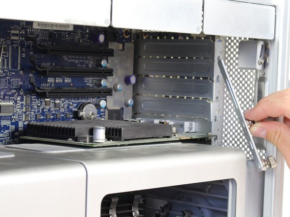

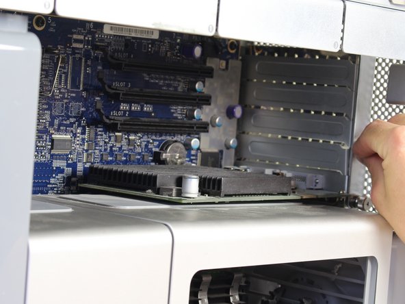

      • Unscrew the two thumb screws by twisting counterclockwise using your fingers until the slide lock is released.
      • Remove the slide lock.

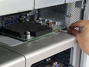

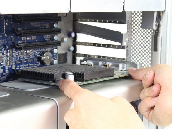

    3. Mac Pro First Generation GPU Replacement: step 5, image 1 of 3 Mac Pro First Generation GPU Replacement: step 5, image 2 of 3 Mac Pro First Generation GPU Replacement: step 5, image 3 of 3
      • Push up on the clip directly behind the graphics card to release it from its slot.
      • Slide the graphics card out of the slot using both hands by firmly holding the corners of the top of the card as shown.
      • Handle the card only by its edges. Don't touch any exposed components or connectors.
