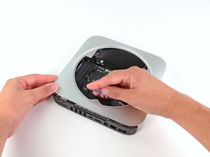

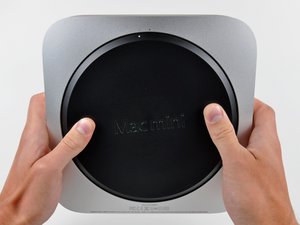

      • Place your thumbs in the depressions cut into the bottom cover.
      • Rotate the bottom cover counter-clockwise until the white dot painted on the bottom cover is aligned with the ring inscribed on the outer case.
      Ask FixBot
    2. Mac mini Mid 2010 Hard Drive Replacement: step 2, image 1 of 1
      • Tilt the mini enough to allow the bottom cover to fall away from the outer case.
      • Remove the bottom cover and set it aside.

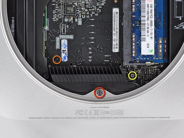

    1. Mac mini Mid 2010 Hard Drive Replacement, Cowling: step 6, image 1 of 1
      • Remove the single 3.5 mm T6 Torx screw securing the cowling to the heat sink.

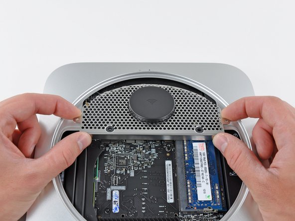

      • Slightly lift the antenna plate from the end closest to the RAM.
      • Carefully pull the antenna plate straight away from the circular rim of the outer case.
      • Do not remove the antenna plate yet. It is still attached to the AirPort/ Bluetooth board.
      Ask FixBot

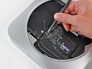

    3. Mac mini Mid 2010 Hard Drive Replacement: step 10, image 1 of 1
      • Use the tip of a spudger to carefully pry the antenna connector up off the AirPort/Bluetooth board.
      Ask FixBot

    1. Mac mini Mid 2010 Hard Drive Replacement, Hard Drive: step 12, image 1 of 1
      • Remove the following three screws:
      • One 5.0 mm T8 Torx or 2.0 mm Hex screw (either will work)
      • One 16.2 mm T6 Torx screw
      • One 26 mm T6 Torx standoff
      • Note: This standoff may have been removed with the fan.

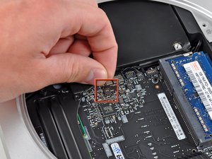

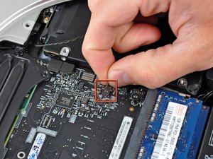

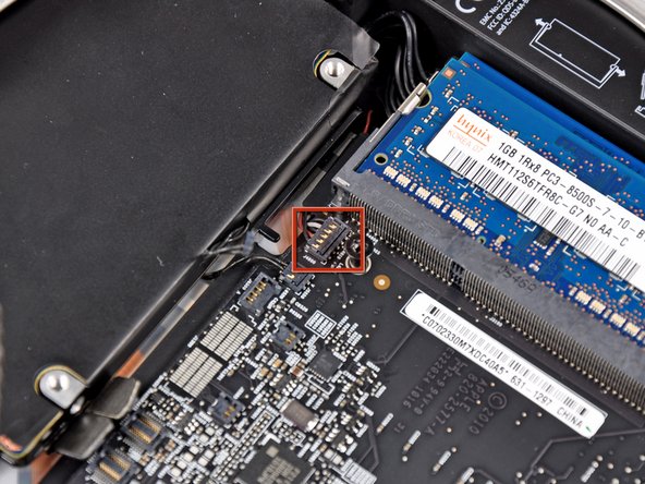

      • Carefully pull the wires for both hard drive thermal sensors upward to lift their connectors up and out of their respective sockets on the logic board.

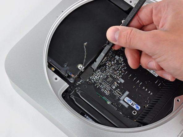

      • Use the flat end of a spudger to pry both the hard drive and optical drive connectors up out of their sockets on the logic board.

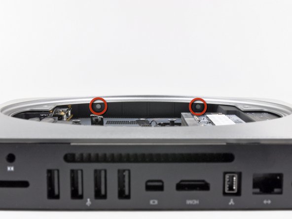

    4. Mac mini Mid 2010 Hard Drive Replacement: step 15, image 1 of 3 Mac mini Mid 2010 Hard Drive Replacement: step 15, image 2 of 3 Mac mini Mid 2010 Hard Drive Replacement: step 15, image 3 of 3

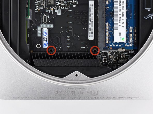

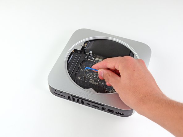

      • For enough clearance to remove the hard drive, the logic board must be slightly removed. To accomplish this, two cylindrical rods must be inserted into the holes highlighted in red.
      • Inserting instruments into any logic board holes other than the ones highlighted in red may severely damage the logic board.
      • Insert a Mac mini Logic Board Removal Tool into the two holes highlighted in red. Be sure it makes contact with the outer case below the logic board before proceeding.
      • If you don't have a Logic Board Removal Tool handy, you can use two tools having a maximum diameter of 2.5 mm instead. Just insert one into each of the highlighted holes.
      • Carefully pull the tool toward the I/O board. The logic board and I/O board assembly should slightly slide out of the outer case.
      • Cease prying when the I/O board is visibly separated from the outer case. Remove the Mac mini Logic Board Removal tool.

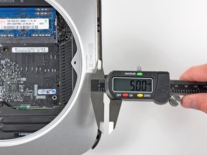

    5. Mac mini Mid 2010 Hard Drive Replacement: step 16, image 1 of 3 Mac mini Mid 2010 Hard Drive Replacement: step 16, image 2 of 3 Mac mini Mid 2010 Hard Drive Replacement: step 16, image 3 of 3
      • Simultaneously push the two plastic clips on the far left and right sides of the I/O board toward the middle of the I/O board and pull the I/O board slightly away from the outer case.
      • Pull the I/O board/logic board assembly out of the outer case a maximum of 5 mm. Pulling the assembly out further may damage the IR sensor connector (highlighted in red in the third picture).

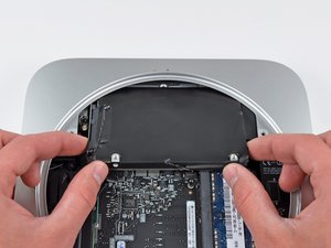

      • Lift the hard drive from the edge nearest the logic board and remove it from the mini, minding the RAM socket and any cables that may get caught.
      • When reinstalling the hard drive, be sure the two T8 Torx lugs on its far end are inserted into the two rubber grommets highlighted in red in the second picture before sliding the logic board back into place.

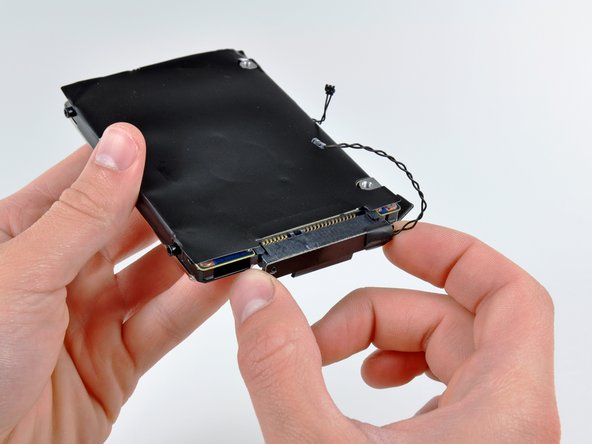

    3. Mac mini Mid 2010 Hard Drive Replacement: step 20, image 1 of 1
      • Remove the piece of tape covering the thermal sensor attached to the edge of the hard drive.

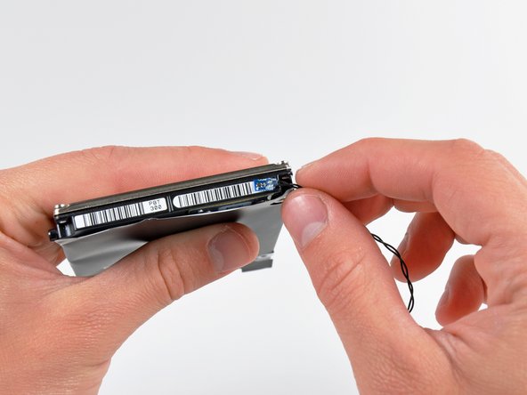

    4. Mac mini Mid 2010 Hard Drive Replacement: step 21, image 1 of 1
      • Carefully peel the thermal sensor off the end of the hard drive.

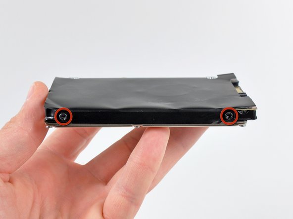

      • Remove the two 6.2 mm T8 Torx screws from the side of the hard drive.

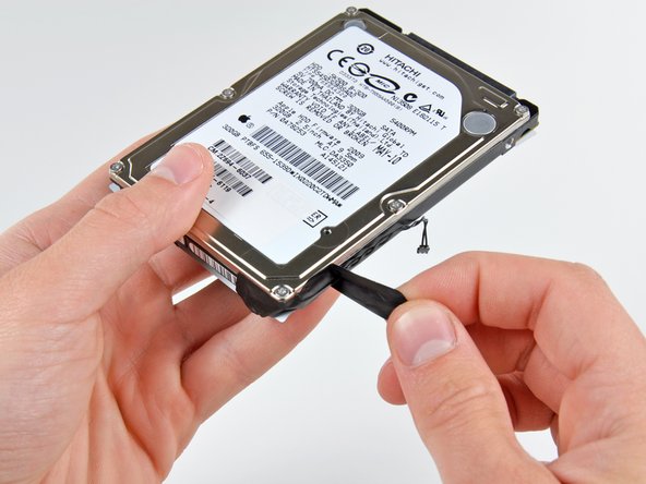

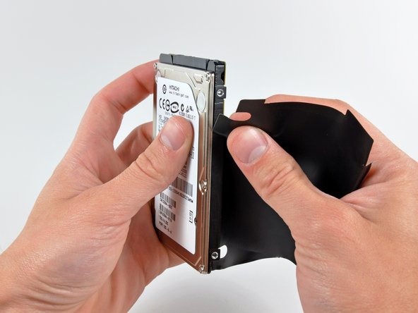

    6. Mac mini Mid 2010 Hard Drive Replacement: step 23, image 1 of 1
      • Carefully peel the hard drive cover off the hard drive.
      • Hard drive remains.
      • If you are installing a new hard drive, we have an OS X install guide to get you up and running.

STEP 15: If you don't have the time to purchase the Mac Mini Logic Board Removal Tool, the round stock on a large binder clip is PERFECT for the job. It requires a little bending and cutting but it worked perfectly!!
And as jon jon stated, it works like a lever - not a pull. You can feel it kind of click in to the lever points below.

Ok, just did here. 1 tera HD working fine. Thanks iFixit, for repacking my tools because the Brazilian mail lost them. So, for those who want to do the same, just have in mind that not ALL things happen just like the how-to. I have to figure out What to do with the logic board removal tool... And, no, I did not fuss with those initial thermal stuff, because they are impossible to unplug. I only fuss with the HD thermal.
