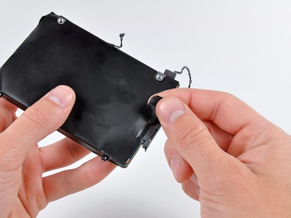

Image 1/1:
  • Remove the strip of tape connecting the hard drive cable to the hard drive.
Image 1/1:
  • Remove the hard drive cable by pulling its connector straight away from the hard drive.
