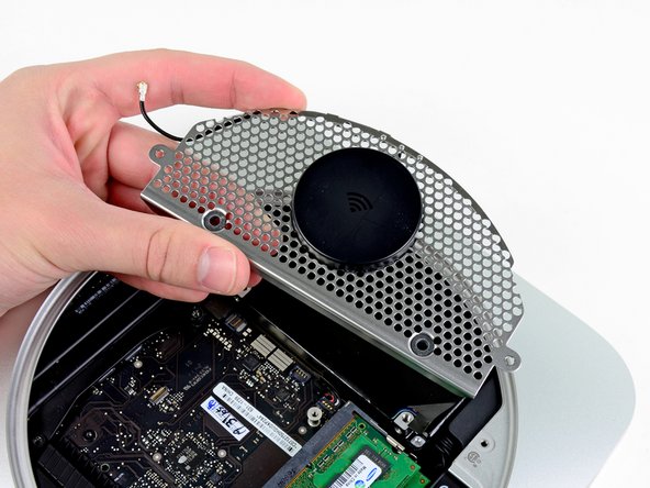

    1. Mac mini Late 2012 Hard Drive Replacement, Antenna Plate: step 8, image 1 of 1
      • Remove the following screws securing the antenna plate to the mini:
      • Two 6.6 mm T8 Torx screws
      • Two 5.0 mm T8 Torx or 2.0 mm Hex screws (either screwdriver will work)
      • When putting back together:
      • It can be difficult to get the hard drive seated correctly such that the antenna plate fits in place correctly. If the screw holes don't line up with those on the hard drive, make sure that the two pins that are in the back of the hard drive are properly seated in the holes at the back of the case, above the housing for the second hard drive.
      • The antenna attaches directly to the hard drive (red markers), therefore attaching the antenna can move the hard drive around and loosen the connection of the hard drive cable to the logic board.
      Ask FixBot

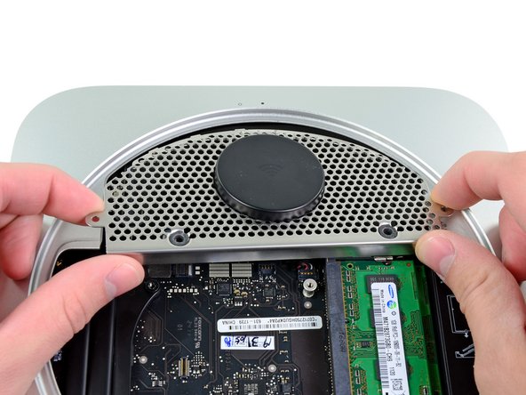

    2. Mac mini Late 2012 Hard Drive Replacement: step 9, image 1 of 2 Mac mini Late 2012 Hard Drive Replacement: step 9, image 2 of 2
      • Slightly lift the antenna plate from the end closest to the RAM.
      • Carefully pull the antenna plate away from the circular rim of the outer case.
      • Do not remove the antenna plate yet. It is still attached to the AirPort/ Bluetooth board.
      Ask FixBot
    3. Mac mini Late 2012 Hard Drive Replacement: step 10, image 1 of 1
      • Use the tip of a spudger to carefully pry the antenna connector up from its socket on the AirPort/Bluetooth board.
      Ask FixBot
    4. Mac mini Late 2012 Hard Drive Replacement: step 11, image 1 of 1
      • Remove the antenna plate from the mini.
      Ask FixBot

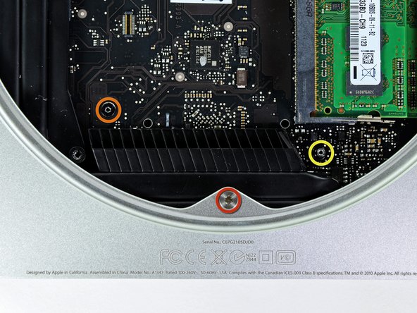

    3. Mac mini Late 2012 Hard Drive Replacement: step 14, image 1 of 1
      • Remove the following three screws:
      • One 5.0 mm T8 Torx or 2.0 mm Hex screw (either screwdriver will work)
      • One 16.2 mm T6 Torx screw
      • One 26 mm T6 Torx standoff
      Ask FixBot

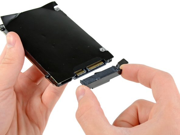

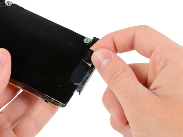

    1. Mac mini Late 2012 Hard Drive Replacement, Hard Drive Cable: step 18, image 1 of 2 Mac mini Late 2012 Hard Drive Replacement, Hard Drive Cable: step 18, image 2 of 2
      • Remove the strip of tape connecting the hard drive cable to the hard drive.
      • Remove the hard drive cable by pulling its connector straight away from the hard drive.
      Ask FixBot

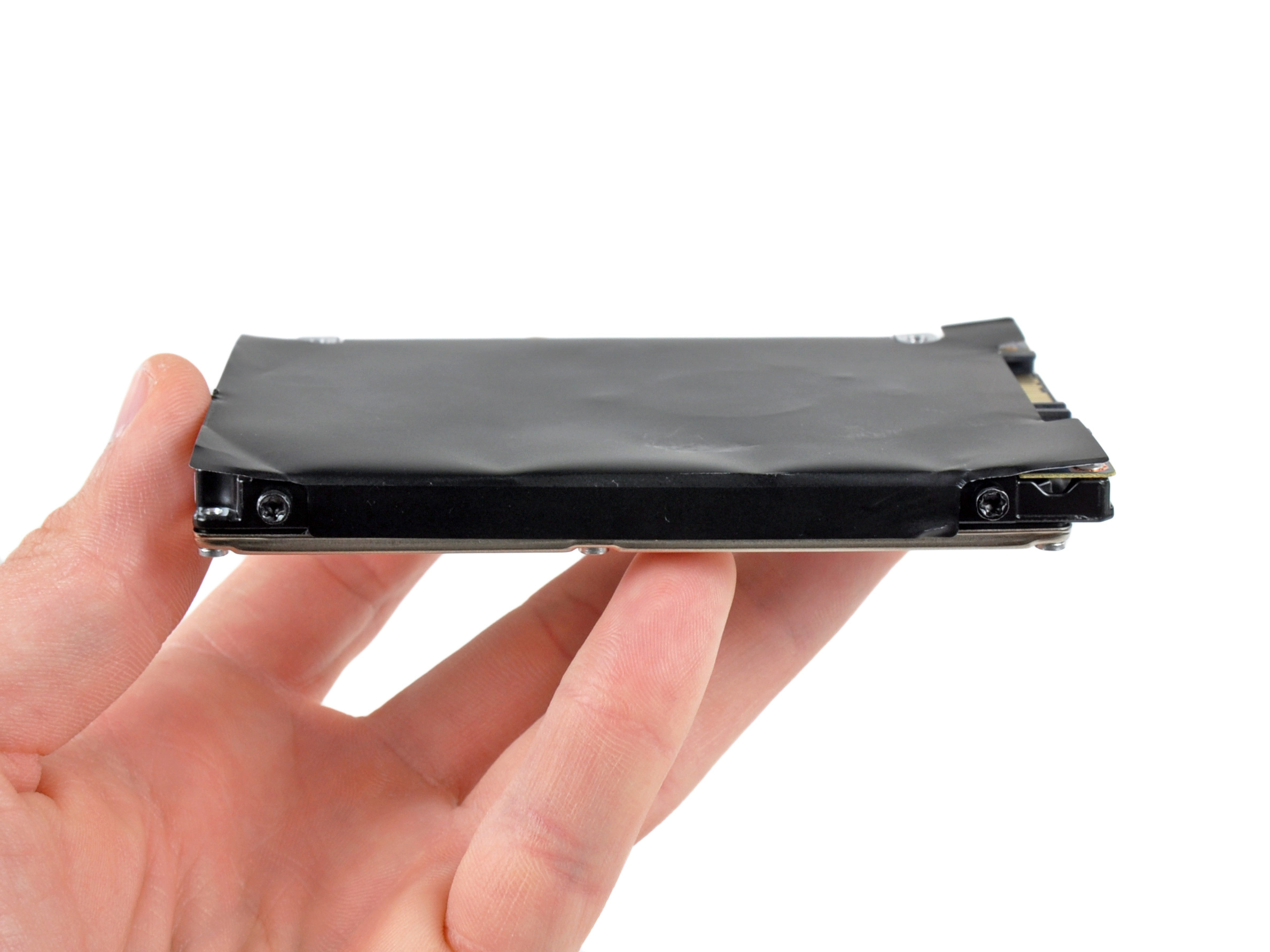

    1. Mac mini Late 2012 Hard Drive Replacement, Hard Drive: step 19, image 1 of 1
      • Remove the hard drive cable.
      • There may be a sticker connecting this cable to the hard drive. If so, remove the sticker before attempting to remove the cable!
      • Remove the two 6.2 mm T8 Torx screws from the side of the hard drive.
      Ask FixBot
    2. Mac mini Late 2012 Hard Drive Replacement: step 20, image 1 of 1
      • Carefully peel the hard drive cover off the hard drive.
      • Hard drive remains.
      • If you are installing a new hard drive, we have an OS X install guide to get you up and running.
