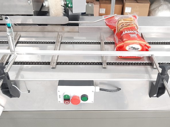

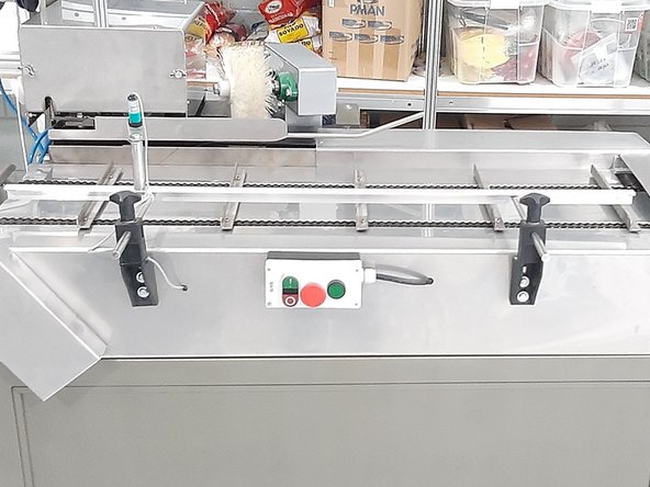

    4. MF 2700A usage training, BUTTON FUNCTIONS: step 4, image 1 of 3 MF 2700A usage training, BUTTON FUNCTIONS: step 4, image 2 of 3 MF 2700A usage training, BUTTON FUNCTIONS: step 4, image 3 of 3
      • Now let's look at the functions of the controller buttons:
      • Power button, intended to turn the machine on or off. (Photo 1)
      • Emergency stop button, intended to turn off the machine in the event of an accident. (Photo 2)
      • Reset, intended to reset the machine when it has been disconnected from power or the emergency stop button has been triggered! (Photo 3)
      • Lacito Tip: The machine offers all safety requirements against electric shock, there is no need to be afraid.
      Ask FixBot
    5. MF 2700A usage training, TURNING ON THE MACHINE: step 5, image 1 of 2 MF 2700A usage training, TURNING ON THE MACHINE: step 5, image 2 of 2
      • Now that we know the functions of the buttons, we can turn on the machine.
      • To do so, press the Green Reset Button to reset the machine! (Photo 1)
      • The next step is to turn on the machine so it will be fully operational; that is, the Conveyor Belt will begin to move. Therefore, be careful not to place your hand or parts of your body near moving parts of the MF 2700A!
      • Next, press the On Button (green) to turn on the machine. (Photo 2)
      • Since the On Button has been pressed, the conveyor belt should begin to move.
      • If the machine does not turn on, contact us at: manutencao1@lacito.com.br or by phone: (11) 94565-8120
      Ask FixBot

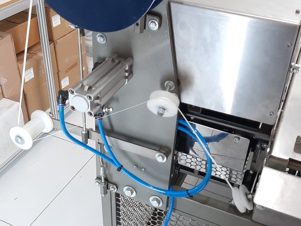

    10. MF 2700A usage training, INSERTING THE STRAP INTO THE MACHINE: step 10, image 1 of 3 MF 2700A usage training, INSERTING THE STRAP INTO THE MACHINE: step 10, image 2 of 3 MF 2700A usage training, INSERTING THE STRAP INTO THE MACHINE: step 10, image 3 of 3
      • The next step is to insert the strap into the machine.
      • To do this, pass the strap through the left side pulley. (Photo 1)
      • After that, pass the strap between the compressed air PU hoses. (Photo 2)
      • Then, pass the strap through the center pulley. (Photo 3).
      Ask FixBot
    11. MF 2700A usage training, LOADING THE STRAPPING ON THE MACHINE: step 11, image 1 of 3 MF 2700A usage training, LOADING THE STRAPPING ON THE MACHINE: step 11, image 2 of 3 MF 2700A usage training, LOADING THE STRAPPING ON THE MACHINE: step 11, image 3 of 3
      • Next, the operator must pass the Strapping through the Alignment pulley. (Photo 1)
      • Then pass the Strapping through the Final guide located slightly inside the machine, as shown in photos 2 and 3.
      Ask FixBot

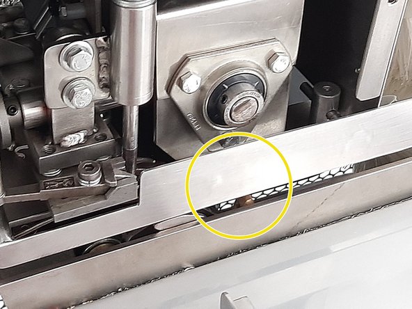

    12. MF 2700A usage training, THREADING THE STRAP INTO THE MACHINE: step 12, image 1 of 2 MF 2700A usage training, THREADING THE STRAP INTO THE MACHINE: step 12, image 2 of 2
      • The next step is to pass the Strap through the machine needle.
      • The Needle is located a little below the protection bracket! (Photo 1)
      • Then simply pass the Strap through the inside of the needle. (Photo 2)
      Ask FixBot

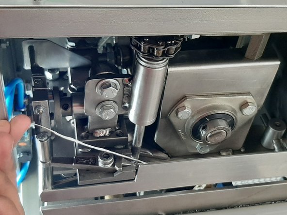

    13. MF 2700A usage training, LOADING THE STRAPPING ON THE MACHINE: step 13, image 1 of 3 MF 2700A usage training, LOADING THE STRAPPING ON THE MACHINE: step 13, image 2 of 3 MF 2700A usage training, LOADING THE STRAPPING ON THE MACHINE: step 13, image 3 of 3
      • After that, pull the strapping upward. (Photo 1)
      • Then, tie the strapping to the knife holder. (Photo 2)
      • Finally, check that the strapping is passing through all the pulleys and the final guide! (Photo 3)
      Ask FixBot

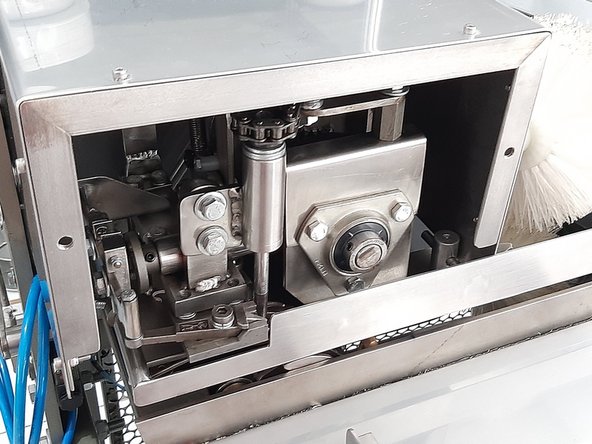

    14. MF 2700A usage training, FINAL ADJUSTMENTS: step 14, image 1 of 2 MF 2700A usage training, FINAL ADJUSTMENTS: step 14, image 2 of 2
      • Finally, just close the Protection Bracket! (Photo 1)
      • To close, simply place the Front Protection Cover, securing it with the Hex Screws! (Photo 2)
      Ask FixBot
