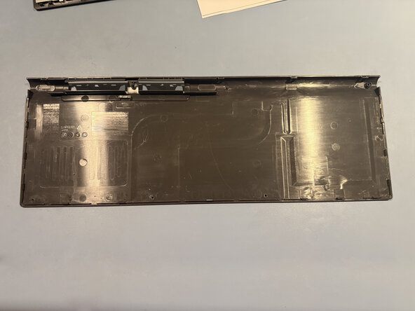

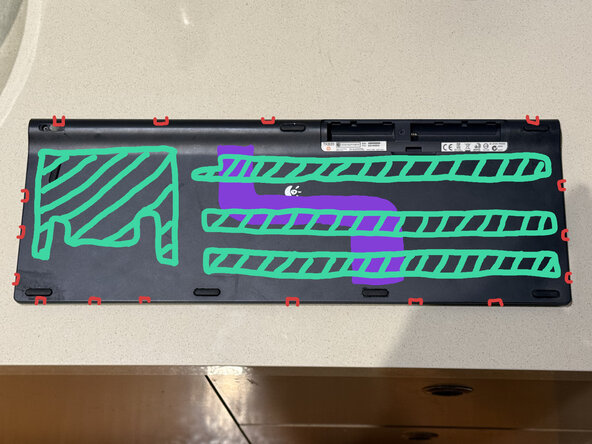

    3. Logitech TK820 Keyboard Disassembly Guide, Heat gun + prise open: step 3, image 1 of 3 Logitech TK820 Keyboard Disassembly Guide, Heat gun + prise open: step 3, image 2 of 3 Logitech TK820 Keyboard Disassembly Guide, Heat gun + prise open: step 3, image 3 of 3
      • Beyond the screws just removed, the keyboard is glued shut, and the frame is also held closed with a number of small plastic clasps.
      • The teal shaded sections of the picture of the keyboard back show the areas where the glue is, and the purple shows the ribbon cable (which also has glue on it) - aim a heatgun at these before attempting to prise the keyboard open for best success.
      • The plastic clasps are shown in orange around the edge of the same picture. They should come apart quite easily with a spudger but be mindful of where they are as you begin to prise the keyboard apart
      • Continue prising the edge and heatgunning the back and inside of the keyboard until it comes apart fully
      • Don't try and remove the blue plastic strip around the edge until the next step, as it is screwed in.
      Ask FixBot
