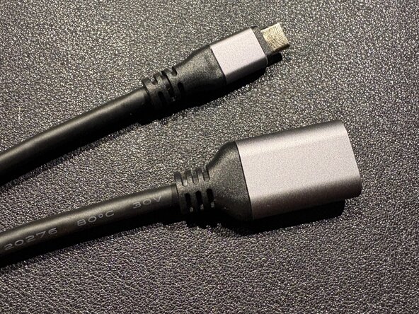

      • The camera requires 5V power to operate. According to the USB-C specification, the cable must have built-in 5.1kΩ pull-down resistors (Rd) on the CC1 and CC2 lines. These resistors allow the power source (PC) to provide 5V to the camera.
      • Plug the cable into a breakout board and use a multimeter to measure the resistance between the CC pins and GND. Verify that the required ~5.1kΩ pull-down resistors are present before proceeding.
      • After verifying the CC resistors, connect the USB-C breakout board to a suitable USB-C power source or PC and connect the donor cable. Measure the voltage between VBUS (VCC) and GND. You should see ~5V.

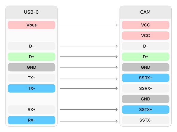

    5. Logitech StreamCam (960-001286) Cable Replacement, Wiring diagram: step 5, image 1 of 2 Logitech StreamCam (960-001286) Cable Replacement, Wiring diagram: step 5, image 2 of 2
      • Do not rely on the wire colors. Use a multimeter and a USB breakout board to identify each wire and match it to the correct pin.
      • USB cable manufacturers can use different colors. Wire colors may vary between cables. For example, in my donor cable, the blue and white wires belonging to the RX and TX twisted pairs were swapped.
      • Connect the wires according to the wiring diagram, making sure each wire is connected to the correct pin.
      • The high-speed twisted pairs have their own shielding. I connected the shielding/drain wires from the RX and TX pairs to the main cable shield. I found it difficult to crimp these shielding wires into the replacement connector and did not have suitable heat-shrink tubing available for this part. The camera nevertheless works just fine.

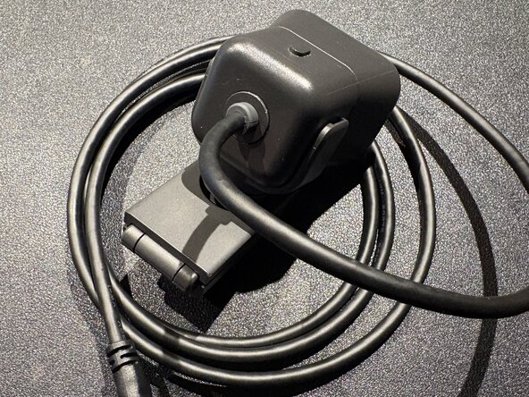

After verifying that the camera operates correctly in USB 3.0 mode and can stream at 1920×1080 - 60 FPS, I can conclude that the repair was successful and the cam is now 100% functional.
