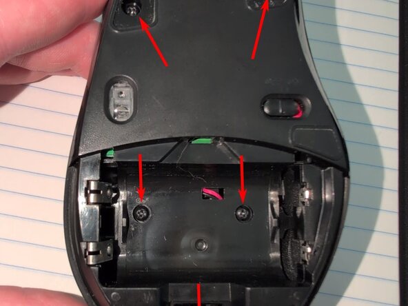

    1. Logitech M705 Scroll Wheel Cleaning, Remove the top cover: step 1, image 1 of 1
      • Remove the 5 screws from the bottom of the mouse
      • The bottom piece should detach from the top piece pretty easily
      Ask FixBot
      • Unplug the 3-wire connector that runs between the top piece and the circuit board
      Ask FixBot

Thank you so much for this excellent guide!
The first problem I had was that the connector would not come loose from the logic board. There is a way to do it of course. There are two little holes at the front of the socket. Poke there with something like a metal pin and then you can pull out the connector more easily.
As mentioned in the guide: take care not to bend the two tiny springs that sit beneath the scroll wheel assembly. And don't lose them! These are vital. I dropped one on the floor and discovered it about 15 minutes later. It took me at least another 20 minutes to find the spring again.
"The plastic piece which can freely flop around on top of the scroll wheel" comes off easily enough. But make a note of how it was positioned! I managed to put it on the other way when I reassembled the mouse.
Don't lose the little plastic pin that secures the scroll wheel assembly and remember how it was positioned originally.
The hardest part I think was to remove the scroll wheel from the clear plastic housing. You will have to be extra careful. In my case the scroll wheel did not fall out and I had to try again and again. Take care not to damage the little plastic slits within the wheel.
Hooray it worked!
