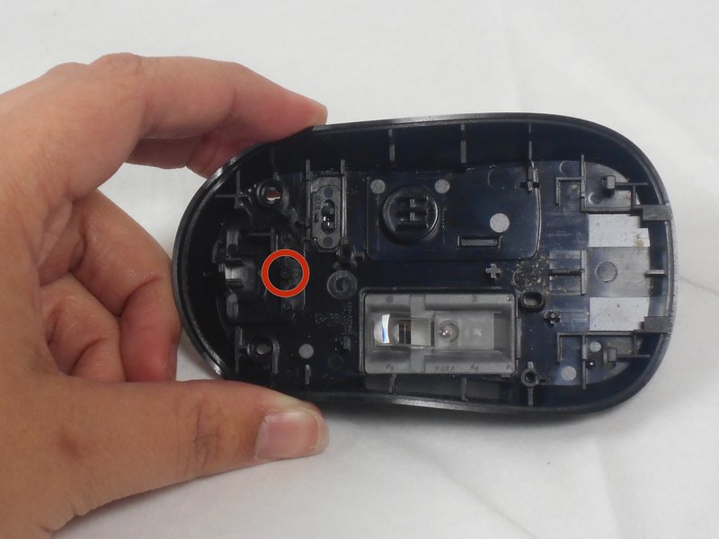

    1. Logitech M215 Cover Release Button Replacement, Cover Release Button: step 6, image 1 of 3 Logitech M215 Cover Release Button Replacement, Cover Release Button: step 6, image 2 of 3 Logitech M215 Cover Release Button Replacement, Cover Release Button: step 6, image 3 of 3
      • Unscrew the 0.25mm phillips head screw holding the button in place. The cover release button can then be removed.
