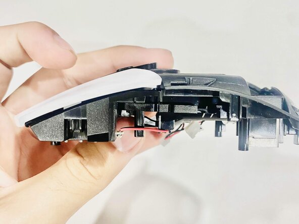

    4. Logitech G305 Mouse Left Clicker Replacement: step 4, image 1 of 2 Logitech G305 Mouse Left Clicker Replacement: step 4, image 2 of 2
      • Open the compartment and slowly separate the halves until the internal wires are exposed.
      • Carefully disconnect the two wires by hand from the base.
      • The wires are fragile and require careful handling.
