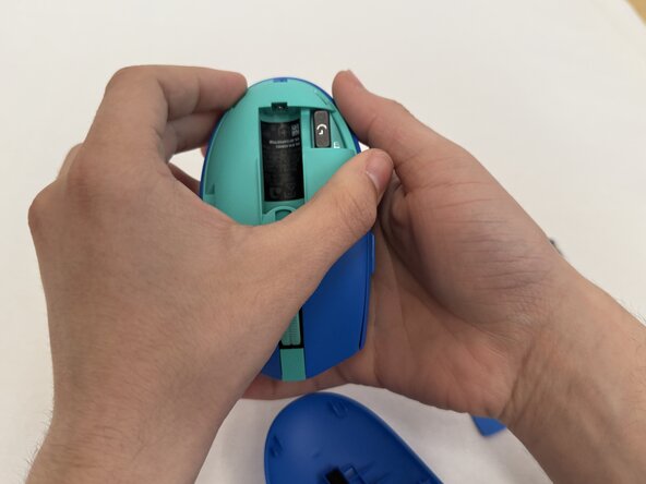

      • Flip the mouse over, and pull down the outer lid exposing the battery.
      • Take out the battery.

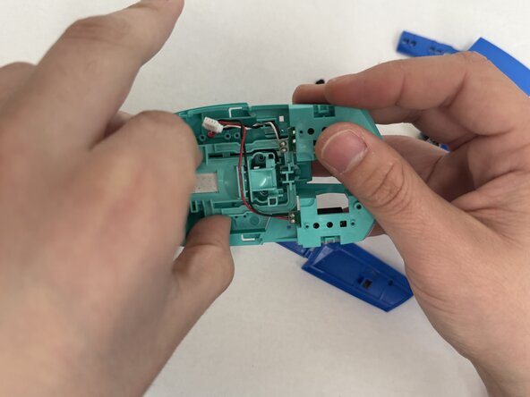

      • Carefully separate the lid of the mouse and locate the two white connectors that link the bottom of the mouse to the top of it.
      • Disconnect these connectors.

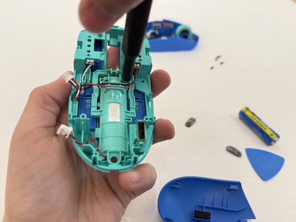

      • Inside of the mouse, remove seven black screws holding the mouse click covers in place.
      Ask FixBot

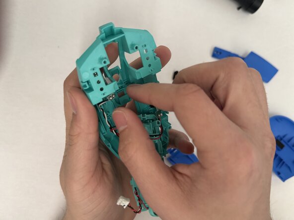

      • Push down the top base of the plastic mouse cover and remove it from the casing.
      • Remove the two newly exposed black screws.
