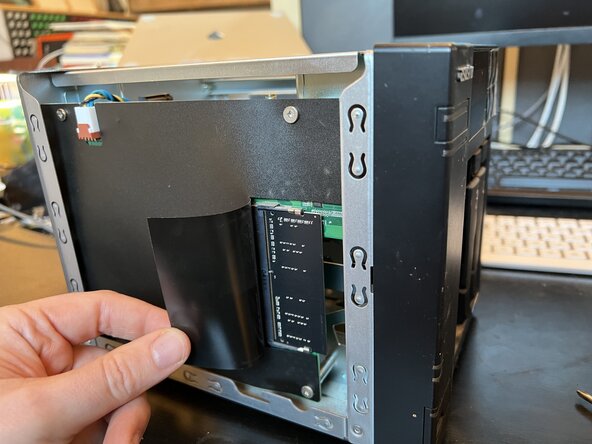

    3. Lockerstor AS6604T disassembly, Second RAM module.: step 3, image 1 of 1
      • Here you can insert a second RAM module (optional).
      Ask FixBot
