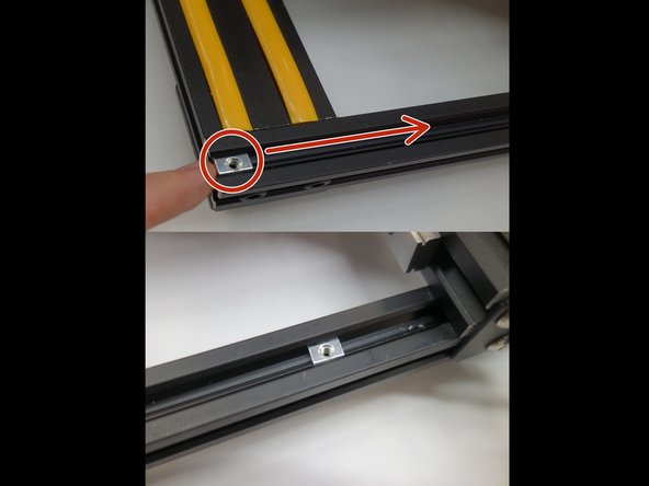

    1. Linear Rail CR10S Endstop Install, Endstop Bracket install: step 1, image 1 of 3 Linear Rail CR10S Endstop Install, Endstop Bracket install: step 1, image 2 of 3 Linear Rail CR10S Endstop Install, Endstop Bracket install: step 1, image 3 of 3
      • M3 Sliding T-Nut
      • Slide in the M3 T-Nut toward the middle of the printer
      • M3X12 BHCS & M3 FLAT WASHERS
      • M3x10 FHCS
      • Adjustable Endstop Mount A
      • Adjustable Endstop Mount B
      • Tighten the M3 screw into the T-Nut

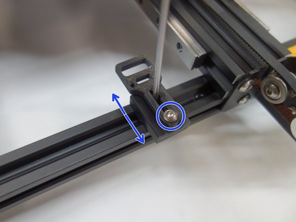

    2. Linear Rail CR10S Endstop Install, Endstop install: step 2, image 1 of 3 Linear Rail CR10S Endstop Install, Endstop install: step 2, image 2 of 3 Linear Rail CR10S Endstop Install, Endstop install: step 2, image 3 of 3
      • Adjust endstop mount until it is square with the Linear rail
      • Remove stock endstop board form Creality mount and Reuse the stock screws to mount the endstop as shown
