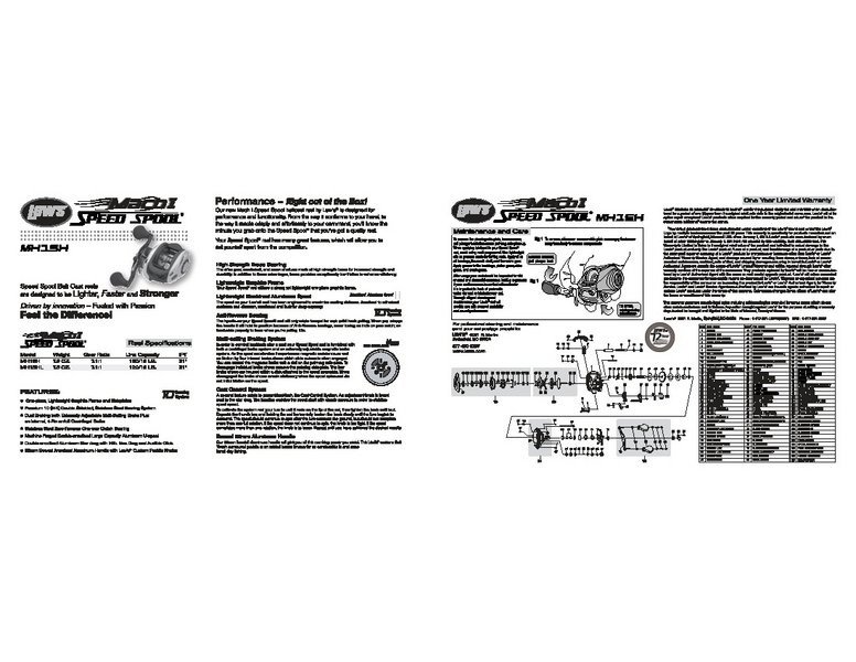

      • Refer to the featured document for specific part names and exploded view. Determine whether you have the right-handed or left-handed reel.
