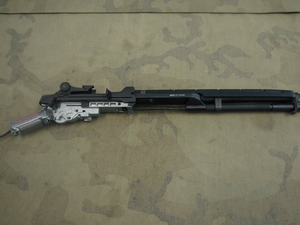

  15. Lever grease gun: step 16, image 1 of 2 Lever grease gun: step 16, image 2 of 2
    • Now you can slide the hop up and other barrel in to the rest of the assemble.
    • Make sure the large part of the charging handle slide into the section marked.
    • Once everything is in position take the large 3mm bolts and screw them to the large holes shown.
    Ask FixBot
  16. Lever grease gun: step 17, image 1 of 3 Lever grease gun: step 17, image 2 of 3 Lever grease gun: step 17, image 3 of 3
    • With the outer barrel bolted down you can now add the charging handle spring and spring guide.
    • First take the spring guide and add the spring to it. Then take the two parts and slide them into the hole of large charging handle section shown.
    • The end of the spring guide a fork like section. This end locks on the the large metal pin that goes threw the front of the gearbox.
    Ask FixBot
  17. Lever grease gun: step 18, image 1 of 3 Lever grease gun: step 18, image 2 of 3 Lever grease gun: step 18, image 3 of 3
    • Now your on the home stretch the gun is almost complete.
    • First start by setting the rear wiring into the stock of the gun.
    • Next line up the front of the outer barrel with the front of the outer barrel as shown.
    • Then with motor sticking into the body press the body and rest of the assemble together.
