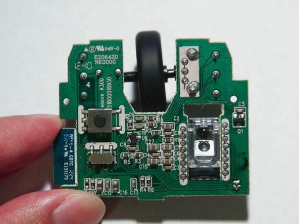

  5. Lenovo bluetooth mouse N6901A disassembly: step 5, image 1 of 2 Lenovo bluetooth mouse N6901A disassembly: step 5, image 2 of 2
    • The micro switch can be replaced by OMRON D2FC-F-7N but you need to trim the solder terminals with a flush wire cutter
    • When you reassemble the mouse, make sure you don't crush the power cable
