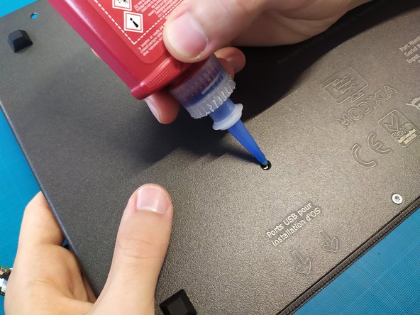

      • Flip the assembly over.
      • Insert a drop of threadlocker into the 2 free holes.
      • Drive the 2 remaining screws in without overtightening at the end.
      • Remove the 2 top screws and reinstall them after applying threadlocker.
      • Tighten the 2 top screws firmly.

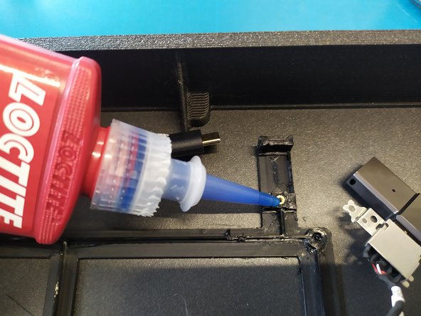

      • Apply a drop of threadlocker.
      • Install one short M3 Torx screw per block WITHOUT TIGHTENING.
      • Once all the blocks are installed, tighten the screws one by one.

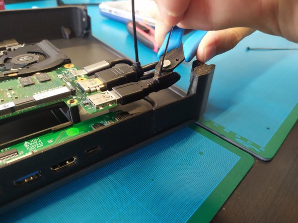

    11. Lenovo X270 Restart PC Build, Zip tie on the cables: step 12, image 1 of 3 Lenovo X270 Restart PC Build, Zip tie on the cables: step 12, image 2 of 3 Lenovo X270 Restart PC Build, Zip tie on the cables: step 12, image 3 of 3
      • Add a zip tie to the HDMI cables and the adjacent USB-A cable.
      • Trim the excess with flush cutters.
      • Hide the "knot" under the cable.
      • Secure the air duct with 2 Phillips M2 screws.
      • Repeat the green points for the dust screen.

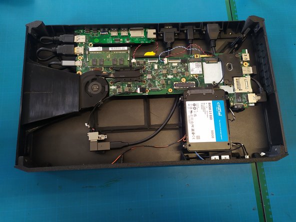

      • Connect the Wi-Fi antennas.
      • Be careful, the uFL connector is fragile.
      • The blue antenna goes on the USB socket side.
      • The orange antenna goes on the air scoop side.
      • Use a cable tie to organize the cables.
      • It is best to position the cables near the SSD slot (for aesthetic reasons).
      Ask FixBot
    15. Lenovo X270 Restart PC Build, Connect the SSD: step 16, image 1 of 3 Lenovo X270 Restart PC Build, Connect the SSD: step 16, image 2 of 3 Lenovo X270 Restart PC Build, Connect the SSD: step 16, image 3 of 3
      • Connect the SSD.
      • Secure it with 3 Phillips M3 screws.
      Ask FixBot

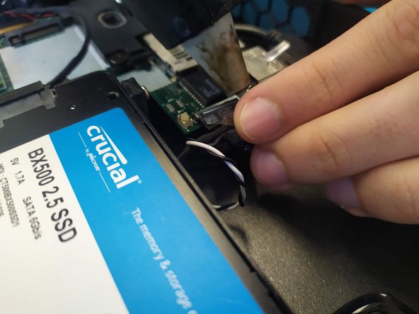

      • Stick the button board onto the nearest post.
      Ask FixBot

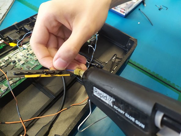

    17. Lenovo X270 Restart PC Build, Glue the power button board connector: step 18, image 1 of 2 Lenovo X270 Restart PC Build, Glue the power button board connector: step 18, image 2 of 2
      • Apply a bead of hot glue to the power button board connector.
      Ask FixBot

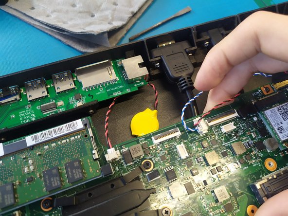

    19. Lenovo X270 Restart PC Build, BIOS Battery Fastener: step 20, image 1 of 3 Lenovo X270 Restart PC Build, BIOS Battery Fastener: step 20, image 2 of 3 Lenovo X270 Restart PC Build, BIOS Battery Fastener: step 20, image 3 of 3
      • Use double-sided tape to secure the battery in the casing.

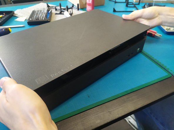

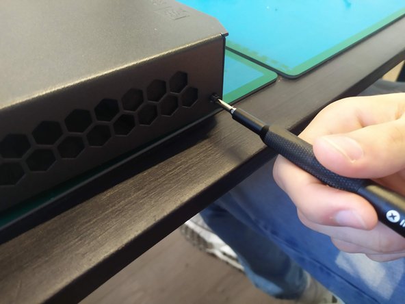

    20. Lenovo X270 Restart PC Build, Installing the upper plate: step 21, image 1 of 2 Lenovo X270 Restart PC Build, Installing the upper plate: step 21, image 2 of 2
      • Install the upper plate.
      • Secure with 4 black M3 Phillips flat-head screws (skip this step if parts are missing).
