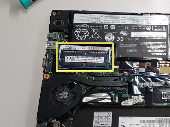

    2. Lenovo ThinkPad X250 RAM Replacement, RAM Replacement: step 2, image 1 of 1
      • Push the metal latches outward on both sides of the memory slot to let the existing stick loose.
      • Pull the old module straight out of the socket.
      • Align the notch on your new RAM stick with the one inside the slot, and insert it at a 45-degree angle.
      • Press down on the top edge of the RAM module until the side latches click and lock it flat into place.
      • Ensure your new RAM stick follows the DDR3L 1600MHz SODIMM standard and does not exceed 16GB.
