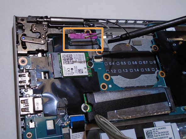

  10. Lenovo ThinkPad X1 Yoga 2nd Generation Keyboard Replacement, Fan: step 10, image 1 of 2 Lenovo ThinkPad X1 Yoga 2nd Generation Keyboard Replacement, Fan: step 10, image 2 of 2
    Tool used on this step:
    Buy
    • Lift up the small, metal tab using a spudger.
    • Do not use the metal spudger unless if it's being used for serious prying power. The metal spudger may damage or puncture internal components in the device if too much pressure is applied.
    • Gently lift the ribbon cable from its socket using nylon-tipped reverse tweezers.

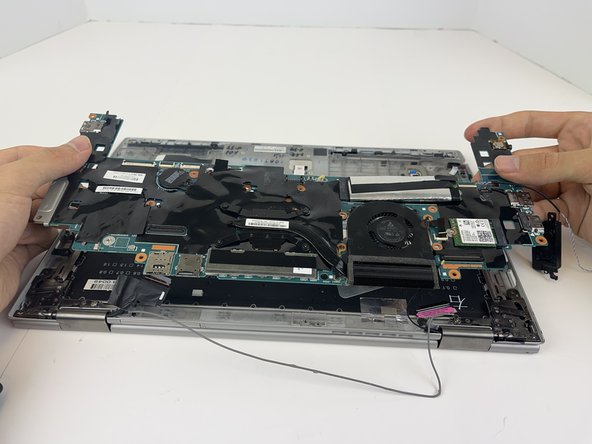

  13. Lenovo ThinkPad X1 Yoga 2nd Generation Keyboard Replacement, Motherboard: step 13, image 1 of 1
    • Using a Phillips #0 screwdriver, remove all 16 of the 6 mm screws connecting the motherboard to the computer.
  14. Lenovo ThinkPad X1 Yoga 2nd Generation Keyboard Replacement: step 14, image 1 of 2 Lenovo ThinkPad X1 Yoga 2nd Generation Keyboard Replacement: step 14, image 2 of 2
    • Using the nylon spudger, disconnect the grey and black wires.
    • Using the nylon spudger, gently disconnect the pink tab from the motherboard.
  15. Lenovo ThinkPad X1 Yoga 2nd Generation Keyboard Replacement: step 15, image 1 of 1
    • Carefully remove the black tape with your fingers.
    • Do not remove the sticky residue from the back of the section.
  16. Lenovo ThinkPad X1 Yoga 2nd Generation Keyboard Replacement: step 16, image 1 of 3 Lenovo ThinkPad X1 Yoga 2nd Generation Keyboard Replacement: step 16, image 2 of 3 Lenovo ThinkPad X1 Yoga 2nd Generation Keyboard Replacement: step 16, image 3 of 3
    • Lift the Black flap using a plastic spudger.
    • Pull out the ribbon cable with the black tab.
  17. Lenovo ThinkPad X1 Yoga 2nd Generation Keyboard Replacement: step 17, image 1 of 1
    • Remove the purple tab by gently pulling it out.
  18. Lenovo ThinkPad X1 Yoga 2nd Generation Keyboard Replacement: step 18, image 1 of 1
    • Remove the blue tab by gently pulling it out.
  19. Lenovo ThinkPad X1 Yoga 2nd Generation Keyboard Replacement: step 19, image 1 of 3 Lenovo ThinkPad X1 Yoga 2nd Generation Keyboard Replacement: step 19, image 2 of 3 Lenovo ThinkPad X1 Yoga 2nd Generation Keyboard Replacement: step 19, image 3 of 3
    • Gently lift up on the sides with your hands and remove the motherboard.

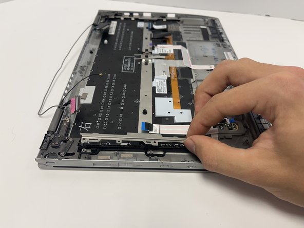

  21. Lenovo ThinkPad X1 Yoga 2nd Generation Keyboard Replacement: step 21, image 1 of 1
    • Use the spudger to gently pry up the ribbon cable.
  22. Lenovo ThinkPad X1 Yoga 2nd Generation Keyboard Replacement: step 22, image 1 of 1
    • Use the spudger to disconnect the ribbon cable.

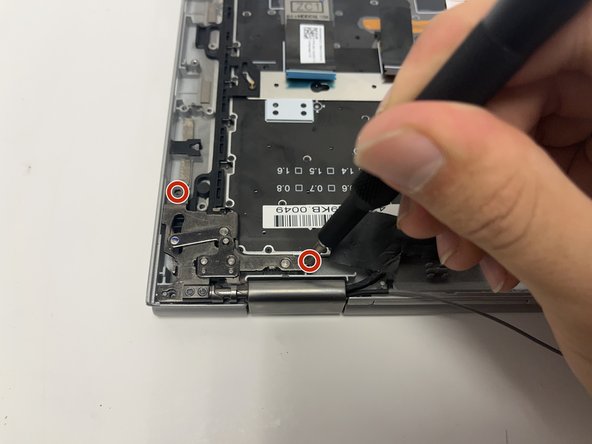

  24. Lenovo ThinkPad X1 Yoga 2nd Generation Keyboard Replacement: step 24, image 1 of 2 Lenovo ThinkPad X1 Yoga 2nd Generation Keyboard Replacement: step 24, image 2 of 2
    • Use the Phillips #0 screwdriver to remove the two 5.4 mm screws connecting the hinge mount to the base.
    • Repeat on the opposite hinge mount.

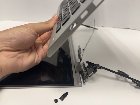

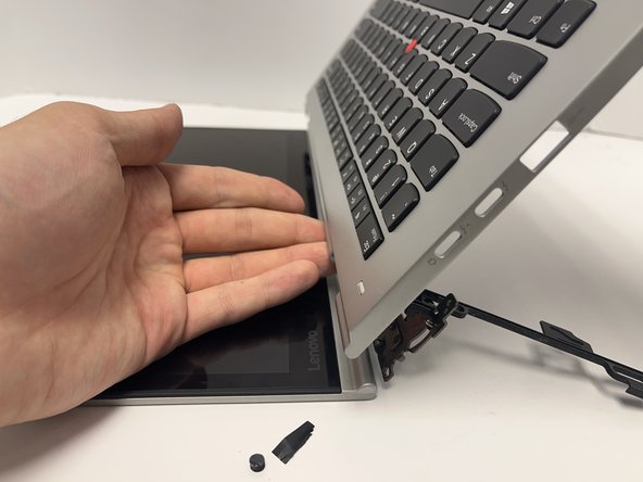

  25. Lenovo ThinkPad X1 Yoga 2nd Generation Keyboard Replacement: step 25, image 1 of 3 Lenovo ThinkPad X1 Yoga 2nd Generation Keyboard Replacement: step 25, image 2 of 3 Lenovo ThinkPad X1 Yoga 2nd Generation Keyboard Replacement: step 25, image 3 of 3
    • Open the laptop hinge by pulling the screen away from the keyboard.
    • Lift the keyboard up and off the hinge brackets.

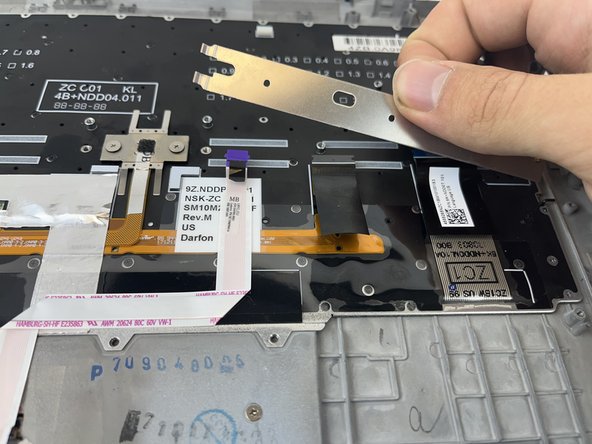

  26. Lenovo ThinkPad X1 Yoga 2nd Generation Keyboard Replacement: step 26, image 1 of 3 Lenovo ThinkPad X1 Yoga 2nd Generation Keyboard Replacement: step 26, image 2 of 3 Lenovo ThinkPad X1 Yoga 2nd Generation Keyboard Replacement: step 26, image 3 of 3
    • Use the Phillips #0 screwdriver to remove the two 3.2 mm screws securing the metal bar on the right side.
    • Repeat with the identical bar on the left.

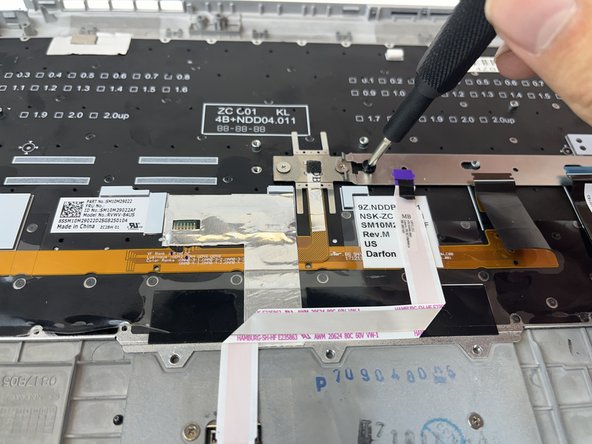

  27. Lenovo ThinkPad X1 Yoga 2nd Generation Keyboard Replacement: step 27, image 1 of 1
    • Use the Phillips #0 screwdriver to remove the two 2.5 mm screws on the metal plate in the center of the keyboard.

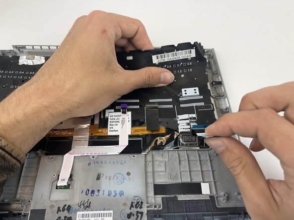

  28. Lenovo ThinkPad X1 Yoga 2nd Generation Keyboard Replacement: step 28, image 1 of 3 Lenovo ThinkPad X1 Yoga 2nd Generation Keyboard Replacement: step 28, image 2 of 3 Lenovo ThinkPad X1 Yoga 2nd Generation Keyboard Replacement: step 28, image 3 of 3

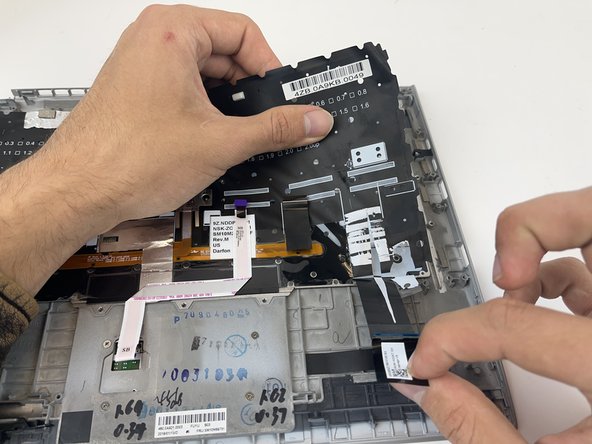

    • Carefully pull back on the black tab to remove the ribbon cable from the back of the keyboard.
  29. Lenovo ThinkPad X1 Yoga 2nd Generation Keyboard Replacement: step 29, image 1 of 3 Lenovo ThinkPad X1 Yoga 2nd Generation Keyboard Replacement: step 29, image 2 of 3 Lenovo ThinkPad X1 Yoga 2nd Generation Keyboard Replacement: step 29, image 3 of 3
    • Use the plastic spudger to pry up the black plastic sheet on the back of the keyboard.
    • Gently pull the sticky edges of the plastic sheet with your hands and a spudger.
    • Lift and carefully remove the plastic sheet.

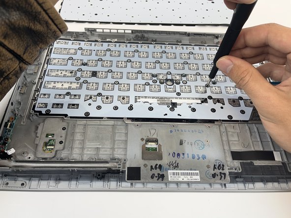

  30. Lenovo ThinkPad X1 Yoga 2nd Generation Keyboard Replacement: step 30, image 1 of 2 Lenovo ThinkPad X1 Yoga 2nd Generation Keyboard Replacement: step 30, image 2 of 2
    • Remove all the 2 mm screws from the back of the keyboard using a Phillips #000 screwdriver.

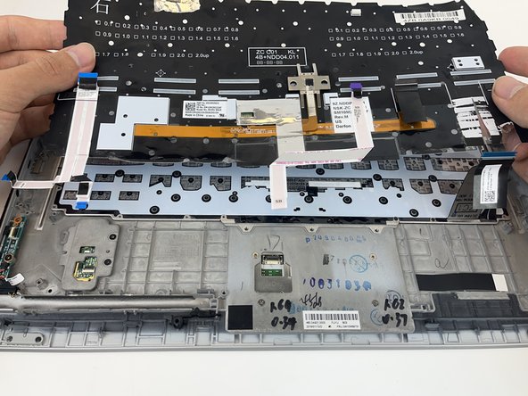

  31. Lenovo ThinkPad X1 Yoga 2nd Generation Keyboard Replacement: step 31, image 1 of 2 Lenovo ThinkPad X1 Yoga 2nd Generation Keyboard Replacement: step 31, image 2 of 2
    • Gently lift the keyboard out of the laptop.
