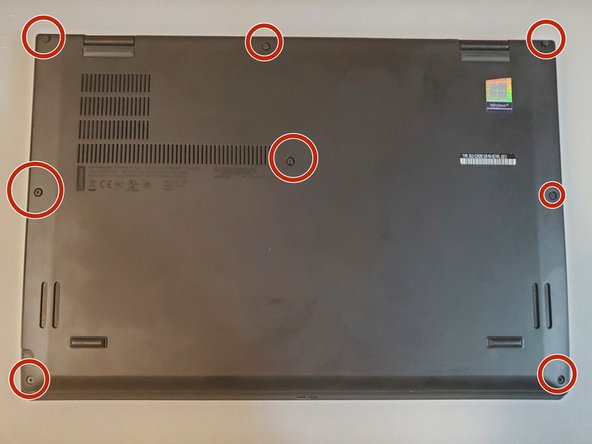

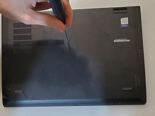

  3. Lenovo ThinkPad X1 Yoga (3rd Gen) SSD Replacement: step 3, image 1 of 3 Lenovo ThinkPad X1 Yoga (3rd Gen) SSD Replacement: step 3, image 2 of 3 Lenovo ThinkPad X1 Yoga (3rd Gen) SSD Replacement: step 3, image 3 of 3
    • Loosen the eight 2 mm-long captive Phillips #00 screws on the lower case.
    • These screws are self-contained in the lower case.

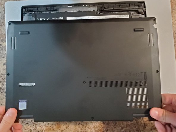

  4. Lenovo ThinkPad X1 Yoga (3rd Gen) SSD Replacement: step 4, image 1 of 3 Lenovo ThinkPad X1 Yoga (3rd Gen) SSD Replacement: step 4, image 2 of 3 Lenovo ThinkPad X1 Yoga (3rd Gen) SSD Replacement: step 4, image 3 of 3
    • Pry the backplate cover away from the laptop using your hands.
    • If you have access to a prying tool, you may use one.
    • Do not bend the backplate. With the screws loosened from the previous step, this panel can be removed with only a little effort.
    • Grasp the plastic shield with your hand and pull it away from the laptop.
    • This will reveal the M.2 slot, where your SSD is installed.
