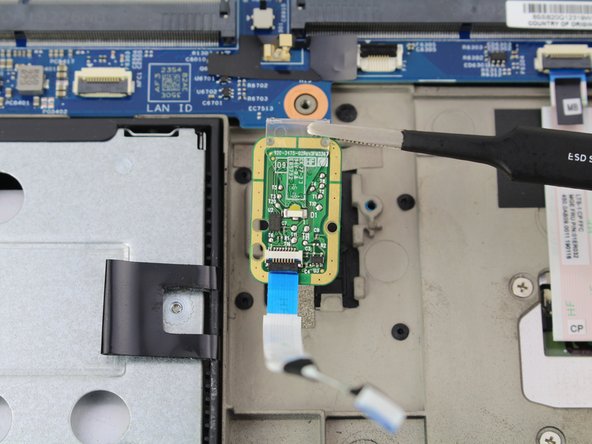

  13. Lenovo ThinkPad T580 Fingerprint Sensor Replacement: step 13, image 1 of 2 Lenovo ThinkPad T580 Fingerprint Sensor Replacement: step 13, image 2 of 2
    • Lift the fingerprint sensor out from the device with a pair of blunt nose tweezers.
