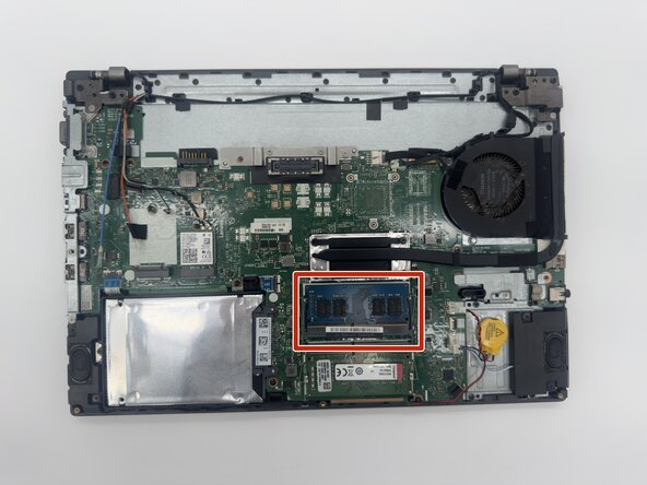

    1. Lenovo ThinkPad L470 RAM Replacement, RAM: step 2, image 1 of 1
      • Use a Phillips #0 screwdriver to loosen the captive screws on the bottom cover.
      Ask FixBot
    2. Lenovo ThinkPad L470 RAM Replacement: step 3, image 1 of 1
      • Use an opening tool to pry the back cover off of the laptop.
      Ask FixBot
    3. Lenovo ThinkPad L470 RAM Replacement: step 4, image 1 of 1
      • Fold back the thin shielding flap to reveal the RAM module(s).
      Ask FixBot
    4. Lenovo ThinkPad L470 RAM Replacement: step 5, image 1 of 2 Lenovo ThinkPad L470 RAM Replacement: step 5, image 2 of 2
      • Gently push the two metal clips on the sides of the RAM outward at the same time.
      • The RAM will pop up at a 30° angle.
      Ask FixBot
    5. Lenovo ThinkPad L470 RAM Replacement: step 6, image 1 of 2 Lenovo ThinkPad L470 RAM Replacement: step 6, image 2 of 2
      • Gently pull the RAM straight out of its slot. If there are two modules, repeat the process for the second slot.
