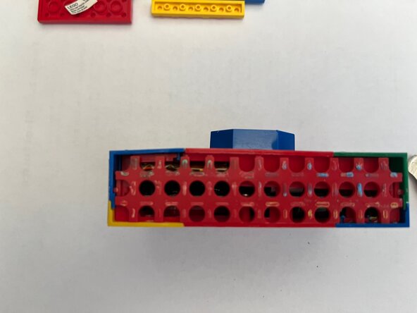

    1. Lego 3MP Digital Camera Replacement Battery Repair, replacement battery: step 1, image 1 of 1
      • I started the disassembly from the bottom; this gives you access to the "panelling" of the walls.
      • The floor sections are attached with plastic adhesive, which can be released piece by piece by inserting a flat, thin metal strip. A watch case opener can also be helpful.

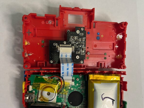

    7. Lego 3MP Digital Camera Replacement Battery Repair: step 7, image 1 of 1
      • The logic board is secured to the rear panel with 4 Phillips screws.
      • The ribbon cables between the housing halves and to the display can be released by sliding the locking mechanism away from the connector.

    9. Lego 3MP Digital Camera Replacement Battery Repair: step 9, image 1 of 1
      • The Li-ion replacement battery measures 41 mm x 30 mm and has a capacity of 550 mAh.
      • By pure coincidence, I had a perfectly fitting replacement battery from a Garmin Edge 820 cycling computer, manufacturer part no. 361-0043-00, with 600 mAh. The connection wires are slightly shorter and had to be extended using wire remnants from the old replacement battery.
      Ask FixBot
