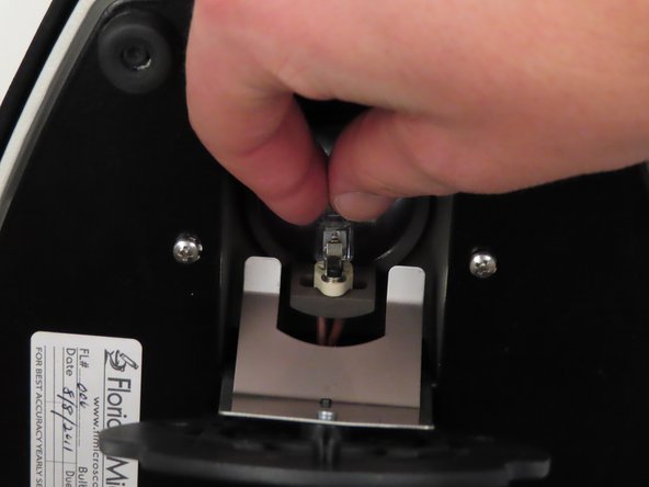

    4. Lecia DME Light Source Bulb  Replacement: step 4, image 1 of 3 Lecia DME Light Source Bulb  Replacement: step 4, image 2 of 3 Lecia DME Light Source Bulb  Replacement: step 4, image 3 of 3
      • Carefully grab both sides of the light bulb.
      • Gently wiggle the light bulb side to side in order to remove it from the socket.

    5. Lecia DME Light Source Bulb  Replacement: step 5, image 1 of 3 Lecia DME Light Source Bulb  Replacement: step 5, image 2 of 3 Lecia DME Light Source Bulb  Replacement: step 5, image 3 of 3
      • Grab a new 20W 12V halogen bulb to replace the broken one.
      • The place for the bulb information is located on the base of the microscope.
      Ask FixBot
    6. Lecia DME Light Source Bulb  Replacement: step 6, image 1 of 3 Lecia DME Light Source Bulb  Replacement: step 6, image 2 of 3 Lecia DME Light Source Bulb  Replacement: step 6, image 3 of 3
      • Take the new light bulb and firmly grasp the sides of it.
      • Insert the new bulb into the now empty socket.
      • Carefully wiggle it into place. Make sure its all the way in the socket to ensure a good connection.
