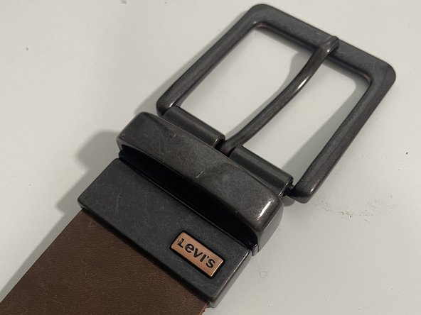

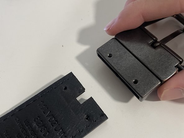

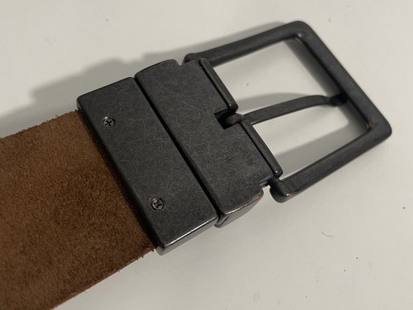

      • Begin by turning the belt buckle around to reveal the screws at the back of the belt.
      Ask FixBot
    2. Leather Belt Strap Replacement: step 2, image 1 of 3 Leather Belt Strap Replacement: step 2, image 2 of 3 Leather Belt Strap Replacement: step 2, image 3 of 3
      • Take a small screwdriver and begin unscrewing the two screws on both sides of the belt buckle.
      • The screws are M2.5x5 Cross Slot Tip Screws for leather accessories.
      Ask FixBot

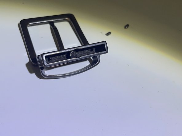

    3. Leather Belt Strap Replacement: step 3, image 1 of 3 Leather Belt Strap Replacement: step 3, image 2 of 3 Leather Belt Strap Replacement: step 3, image 3 of 3
      • Remove the unscrewed belt buckle away from the old leather strap.
      Ask FixBot

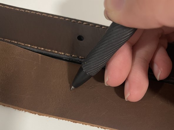

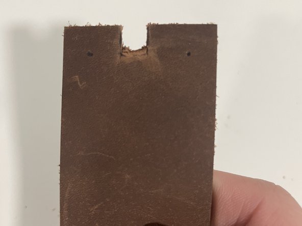

    4. Leather Belt Strap Replacement: step 4, image 1 of 3 Leather Belt Strap Replacement: step 4, image 2 of 3 Leather Belt Strap Replacement: step 4, image 3 of 3

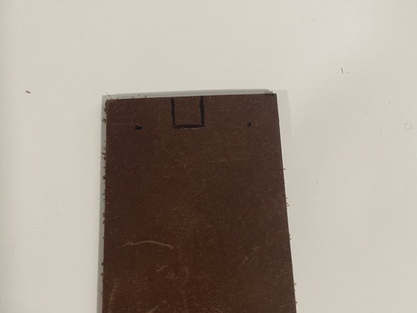

      • Take new leather belt strap and align it with the old leather strap.
      • Take a pen and approximately mark the areas where the cuts will be made.
      Ask FixBot
    5. Leather Belt Strap Replacement: step 5, image 1 of 2 Leather Belt Strap Replacement: step 5, image 2 of 2
      • Take the pen.
      • Draw two circles where the screws will be screwed in.
      Ask FixBot

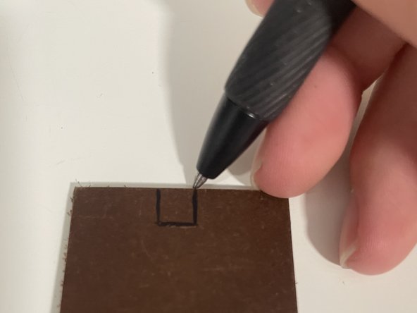

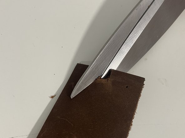

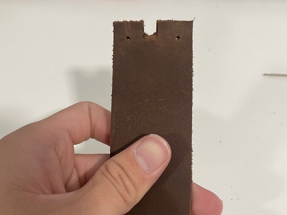

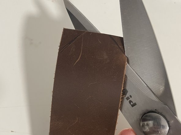

    6. Leather Belt Strap Replacement: step 6, image 1 of 3 Leather Belt Strap Replacement: step 6, image 2 of 3 Leather Belt Strap Replacement: step 6, image 3 of 3
      • Take the new leather belt strap with markings made.
      • Use a scissor to cut out the square mark on the new leather belt strap.
      Ask FixBot

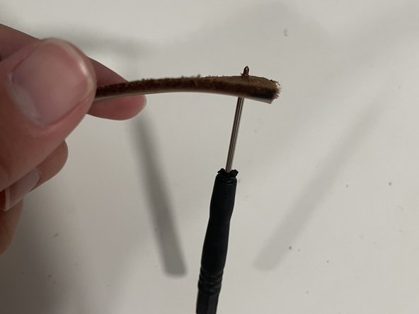

    7. Leather Belt Strap Replacement: step 7, image 1 of 3 Leather Belt Strap Replacement: step 7, image 2 of 3 Leather Belt Strap Replacement: step 7, image 3 of 3
      • Take a small screwdriver and puncture the two small circles on the new leather belt strap.
      • Make sure that the holes are punctured through.
      • If the screwdriver is not sharp enough to puncture the hole, you may use a small sharp object such as a hand held needle.
      Ask FixBot

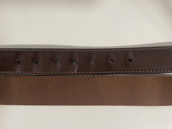

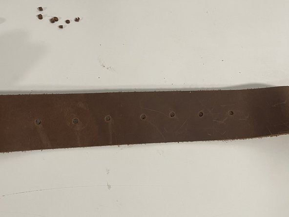

    10. Leather Belt Strap Replacement: step 10, image 1 of 3 Leather Belt Strap Replacement: step 10, image 2 of 3 Leather Belt Strap Replacement: step 10, image 3 of 3
      • Now take the old and new leather belt strap
      • Align both leather belt straps side by side. (The old leather belt strap will be used as a reference)
      • Use a pen to draw circles that are an equal distance apart.
      • Start by drawing the same number of circles that are on the old belt strap.
      Ask FixBot

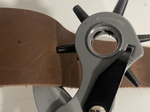

    11. Leather Belt Strap Replacement: step 11, image 1 of 3 Leather Belt Strap Replacement: step 11, image 2 of 3 Leather Belt Strap Replacement: step 11, image 3 of 3
      • Take the revolving leather puncher.
      • Rotate the setting clockwise to the third or fourth-largest setting. (This will ensure that the buckle's prong will fit through the holes)
      • Now insert the leather puncher and align it with the circle.
      • To punch a hole through the leather, squeeze the handle thoroughly until the leather punch clicks.
      Ask FixBot

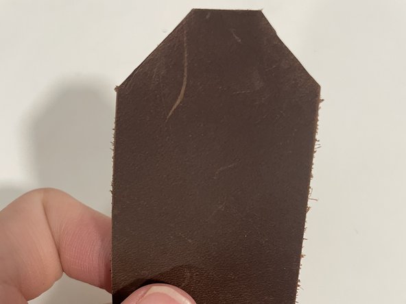

    12. Leather Belt Strap Replacement: step 12, image 1 of 3 Leather Belt Strap Replacement: step 12, image 2 of 3 Leather Belt Strap Replacement: step 12, image 3 of 3
      • THIS STEP IS OPTIONAL
      • Use the pen to draw detail marking to the end of the new leather belt strap.
      • Take the kitchen scissors and cut the leather belt according to the detail.
      Ask FixBot
