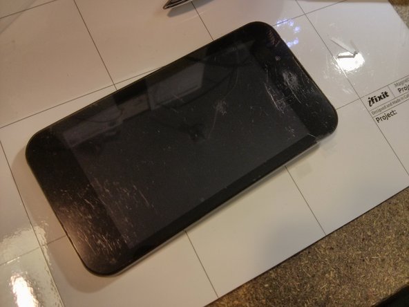

Use this guide to replace your LG-P970 touch screen.
You can buy this part on amazon http://www.amazon.fr/dp/B00CF29W78
    1. LG-P970 touch screen Replacement, touch screen: step 1, image 1 of 3 LG-P970 touch screen Replacement, touch screen: step 1, image 2 of 3 LG-P970 touch screen Replacement, touch screen: step 1, image 3 of 3
      • remove the back cover
      • remove the battery
      • remove the SIM card
      • remove the µSD card (Memory)

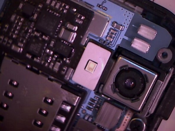

      • remove buttons
      • locate the back camera
      • with a tool raise up the led.carefully
      Ask FixBot
    4. LG-P970 touch screen Replacement: step 4, image 1 of 3 LG-P970 touch screen Replacement: step 4, image 2 of 3 LG-P970 touch screen Replacement: step 4, image 3 of 3
      • with a tool disconnect the back camera
      • and remove the camera with your fingers.
      Ask FixBot
    5. LG-P970 touch screen Replacement: step 5, image 1 of 2 LG-P970 touch screen Replacement: step 5, image 2 of 2
      • don't forget to remove the little connector of screen, with a tool, right next to the empty slot of the camera.
