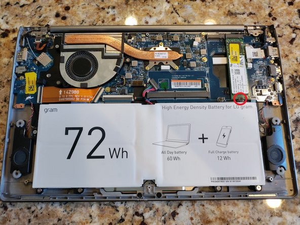

  4. LG gram (14Z980-A.AAS7U1) SSD Replacement, Disconnect battery: step 4, image 1 of 2 LG gram (14Z980-A.AAS7U1) SSD Replacement, Disconnect battery: step 4, image 2 of 2
    • Carefully locate the battery connector within the laptop and gently detach it from its port by applying pressure and pulling it straight out.
  5. LG gram (14Z980-A.AAS7U1) SSD Replacement, Remove drive screw: step 5, image 1 of 2 LG gram (14Z980-A.AAS7U1) SSD Replacement, Remove drive screw: step 5, image 2 of 2
    • Utilize a Phillips screwdriver to unscrew the 2.8 mm-sized screw that secures the SSD onto the LG Gram's motherboard.
  6. LG gram (14Z980-A.AAS7U1) SSD Replacement, Disconnect drive: step 6, image 1 of 2 LG gram (14Z980-A.AAS7U1) SSD Replacement, Disconnect drive: step 6, image 2 of 2
    • Carefully grip the SSD by its edges and gently pull it straight out.
    • Avoid any abrupt movements to prevent damage to the drive.
  7. LG gram (14Z980-A.AAS7U1) SSD Replacement, Connect new drive: step 7, image 1 of 2 LG gram (14Z980-A.AAS7U1) SSD Replacement, Connect new drive: step 7, image 2 of 2
    • Gently push the drive into the slot until it's snugly in place.
    • Apply even pressure to ensure a secure connection.
