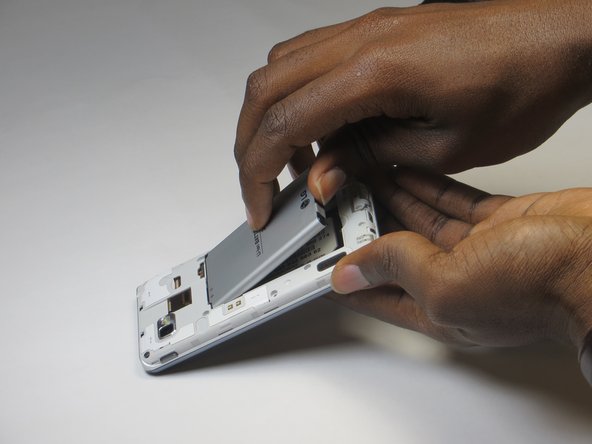

    1. LG VM720 Volume Button Removal, Power Button Removal: step 1, image 1 of 2 LG VM720 Volume Button Removal, Power Button Removal: step 1, image 2 of 2
      • Remove the back cover followed by removing the battery.
      Ask FixBot

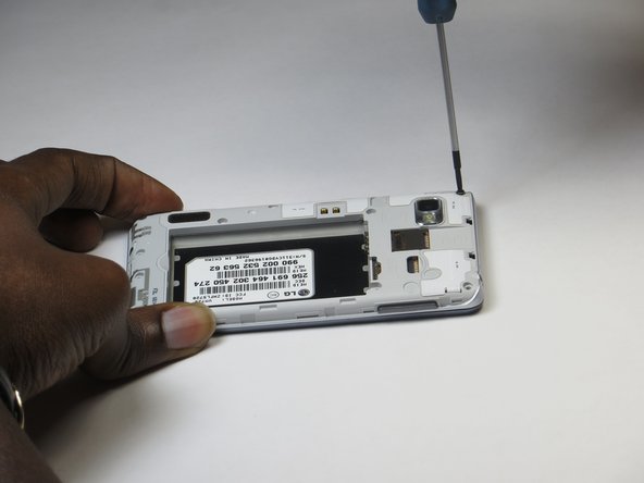

    2. LG VM720 Volume Button Removal: step 2, image 1 of 2 LG VM720 Volume Button Removal: step 2, image 2 of 2
      • With the back panel exposed,begin by removing 10 screws located at the back side of the phone.
      Ask FixBot

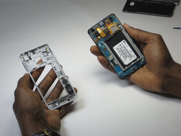

    3. LG VM720 Volume Button Removal: step 3, image 1 of 2 LG VM720 Volume Button Removal: step 3, image 2 of 2
      • Using a sharp tool, loosen the edges and slowly detach the front screen panel from the back panel.
      Ask FixBot
