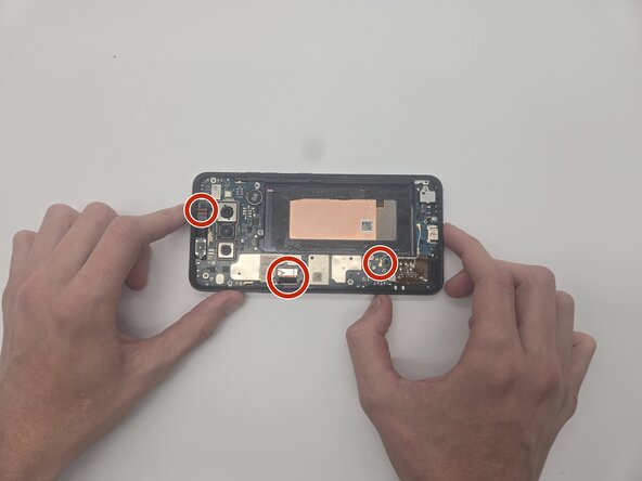

    1. LG V40 ThinQ  Power/Volume Buttons Replacement, Power/Volume Buttons: step 10, image 1 of 3 LG V40 ThinQ  Power/Volume Buttons Replacement, Power/Volume Buttons: step 10, image 2 of 3 LG V40 ThinQ  Power/Volume Buttons Replacement, Power/Volume Buttons: step 10, image 3 of 3
      • Use opening picks to detach the motherboard cables.
      • Remove the motherboard.

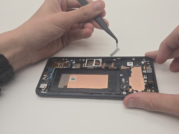

    4. LG V40 ThinQ  Power/Volume Buttons Replacement: step 13, image 1 of 3 LG V40 ThinQ  Power/Volume Buttons Replacement: step 13, image 2 of 3 LG V40 ThinQ  Power/Volume Buttons Replacement: step 13, image 3 of 3
      • Remove the tape covering the power button.
      • Using the Angled ESD precision Tweezers, remove the power button.
      Ask FixBot
