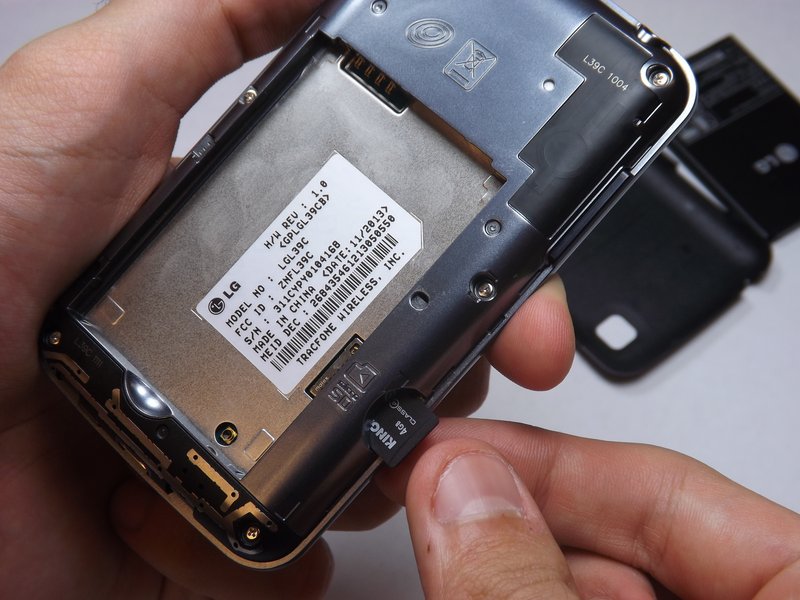

    1. LG Optimus Dynamic II L39C Screen Replacement, Remove the SD Card: step 3, image 1 of 1
      • Grab the end of the SD Card and pull it out of the phone.
