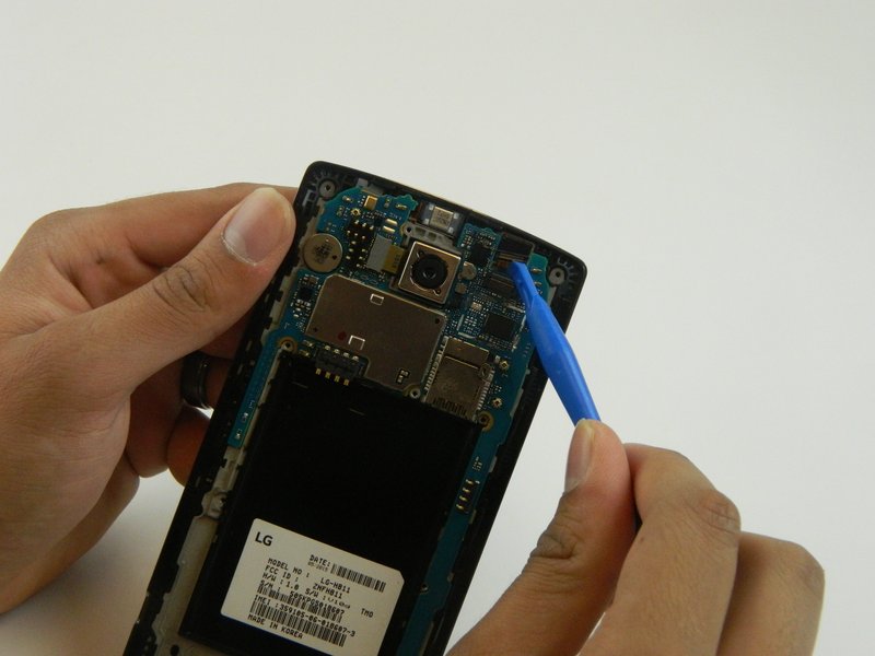

    1. LG G4 Front Camera Replacement, Front Camera: step 5, image 1 of 3 LG G4 Front Camera Replacement, Front Camera: step 5, image 2 of 3 LG G4 Front Camera Replacement, Front Camera: step 5, image 3 of 3
      • Detach the Front Camera ribbon cable located on the top right corner of the back of the phone by gently lifting it up with a plastic opening tool. Remove the front camera.
      • Be careful when removing the cables and pulling out the front camera to avoid tearing the attached cable.
