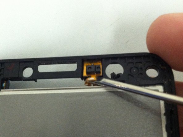

    1. LG Escape (p870) Front Camera Replacement, Front Camera: step 15, image 1 of 2 LG Escape (p870) Front Camera Replacement, Front Camera: step 15, image 2 of 2
      • Using a spudger or a small flathead screwdriver, pry the front camera out of its socket, but to not remove it from the phone
      • Turn the phone over and peel the adhesive portion of the camera's flex cable off of the phone
      • Remove the camera and set it aside
