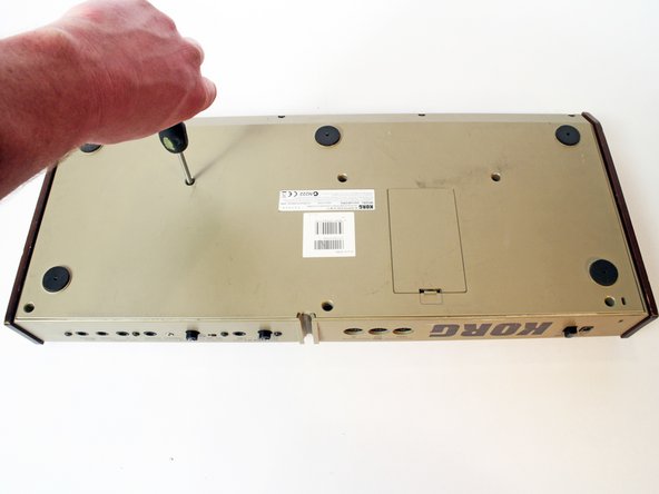

    3. Korg MicroKORG Key Contact Strip Repair, Remove Back Cover: step 3, image 1 of 2 Korg MicroKORG Key Contact Strip Repair, Remove Back Cover: step 3, image 2 of 2
      • Unscrew 11 Phillips screws.
      • Lift cover up to expose battery compartment.

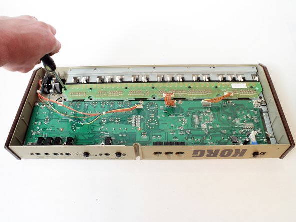

    4. Korg MicroKORG Key Contact Strip Repair, Disconnect Battery Compartment: step 4, image 1 of 3 Korg MicroKORG Key Contact Strip Repair, Disconnect Battery Compartment: step 4, image 2 of 3 Korg MicroKORG Key Contact Strip Repair, Disconnect Battery Compartment: step 4, image 3 of 3
      • Grip connector and lift.
      • Set back cover off to the side.

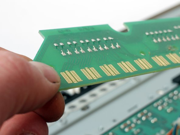

    5. Korg MicroKORG Key Contact Strip Repair, Remove Key Contact Board: step 5, image 1 of 3 Korg MicroKORG Key Contact Strip Repair, Remove Key Contact Board: step 5, image 2 of 3 Korg MicroKORG Key Contact Strip Repair, Remove Key Contact Board: step 5, image 3 of 3
      • Unscrew 7 Phillips screws.
      • Lift contact board up.
      • Rotate board forward.
      • *You do not have to disconnect the contact board. Save time (plus it's easier to verify your work) by leaving it attached.

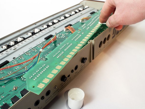

    6. Korg MicroKORG Key Contact Strip Repair, Clean Contacts: step 6, image 1 of 3 Korg MicroKORG Key Contact Strip Repair, Clean Contacts: step 6, image 2 of 3 Korg MicroKORG Key Contact Strip Repair, Clean Contacts: step 6, image 3 of 3
      • These contacts look clean, but give em' a scrub regardless.
      • Locate the problem keys (from step 1) and make certain they are clear of debris.
      • Dab a Q-tip in the alcohol and give each contact a cleaning.
      • Repeat the process with the dry side of the Q-tip to remove any build up.

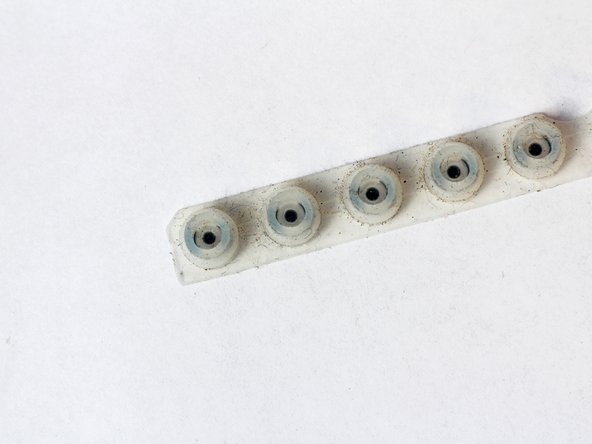

    7. Korg MicroKORG Key Contact Strip Repair, Remove Rubber Contact Strip: step 7, image 1 of 2 Korg MicroKORG Key Contact Strip Repair, Remove Rubber Contact Strip: step 7, image 2 of 2
      • Lift and remove each contact strip.
      • Clean the underside of these three strips. Keyboards accumulate all sorts of gunk, so each strip must be removed to access the nasty.
      • * If the contact strips are in bad shape, they may need replacing.
      Ask FixBot
    8. Korg MicroKORG Key Contact Strip Repair, Clean Contact Side of Strip: step 8, image 1 of 2 Korg MicroKORG Key Contact Strip Repair, Clean Contact Side of Strip: step 8, image 2 of 2
      • Dab another Q-tip and clean each contact point.
      • Repeat with the dry side of the Q-tip to remove any build up.
