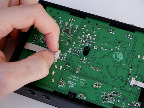

    3. Komplete Audio 2 USB Port Replacement, Unlocking the ribbon cables: step 3, image 1 of 3 Komplete Audio 2 USB Port Replacement, Unlocking the ribbon cables: step 3, image 2 of 3 Komplete Audio 2 USB Port Replacement, Unlocking the ribbon cables: step 3, image 3 of 3
      • The main PCB has two ribbon cables connected to it. In this step, we will ensure they can be safely disconnected.
      • Unlock the ribbon cables by gently pulling the grey locking tabs of the connectors outwards (as indicated in the second image).
      • Newer models (often MK2) no longer use locking tabs; the cables are simply push-fit. If you have this version, do not try to unlock anything. Proceed directly to the next step to gently pull them out.
      Ask FixBot
    4. Komplete Audio 2 USB Port Replacement, Disconnecting the ribbon cables: step 4, image 1 of 2 Komplete Audio 2 USB Port Replacement, Disconnecting the ribbon cables: step 4, image 2 of 2
      • Now that the connectors are ready, we can safely disconnect the cables from the main PCB.
      • Disconnect both ribbon cables by gently pulling them out of their connectors.
      • You may need to wiggle the cables slightly side-to-side to loosen them from the sockets.
      Ask FixBot

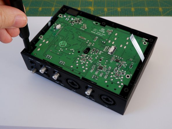

    5. Komplete Audio 2 USB Port Replacement, Main PCB screws: step 5, image 1 of 3 Komplete Audio 2 USB Port Replacement, Main PCB screws: step 5, image 2 of 3 Komplete Audio 2 USB Port Replacement, Main PCB screws: step 5, image 3 of 3
      • The main PCB is secured by six screws. We will remove them in this step.
      • Use a Phillips #0 screwdriver to remove the six screws from the main PCB.
      Ask FixBot
    6. Komplete Audio 2 USB Port Replacement, Front panel screws: step 6, image 1 of 3 Komplete Audio 2 USB Port Replacement, Front panel screws: step 6, image 2 of 3 Komplete Audio 2 USB Port Replacement, Front panel screws: step 6, image 3 of 3
      • There are two screws securing the front panel to the case. They are recessed deeply inside the enclosure and might not be immediately visible.
      • Use a Phillips #0 screwdriver to remove the two screws, as shown in the photos.
      Ask FixBot

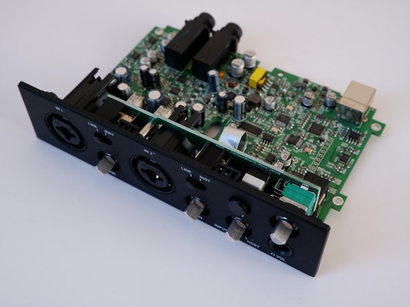

    7. Komplete Audio 2 USB Port Replacement, Detaching the front panel: step 7, image 1 of 3 Komplete Audio 2 USB Port Replacement, Detaching the front panel: step 7, image 2 of 3 Komplete Audio 2 USB Port Replacement, Detaching the front panel: step 7, image 3 of 3
      • With the screws removed, the front panel can now be unclipped from the top cover.
      • Gently pry the sides of the front panel as indicated by the arrows in the first image.
      • Pull the front panel upwards until it detaches from the top cover.
      • This step requires some patience and finesse. Take your time and avoid applying excessive force to prevent damage.
      • The USB port is fitted with a plastic cover that is only loosely attached to the main PCB. It is prone to falling out once the board is removed. Keep an eye on it to ensure it doesn't get lost!
      Ask FixBot
    8. Komplete Audio 2 USB Port Replacement, USB port replacement: step 8, image 1 of 3 Komplete Audio 2 USB Port Replacement, USB port replacement: step 8, image 2 of 3 Komplete Audio 2 USB Port Replacement, USB port replacement: step 8, image 3 of 3
      • To replace the USB port, you will first need to desolder the existing one.
      • The locations of the relevant pins are indicated in pictures 2 and 3.
      • If you are new to desoldering, take a look at our guide on How To Solder and Desolder Connections.
      • Desolder the faulty USB port from the main PCB and then solder in the replacement part.
      Ask FixBot
