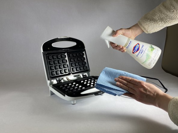

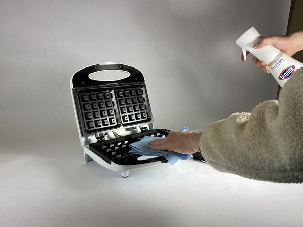

    3. Kitchen Gourmet Waffle Maker Release Latch Spring Replacement: step 3, image 1 of 3 Kitchen Gourmet Waffle Maker Release Latch Spring Replacement: step 3, image 2 of 3 Kitchen Gourmet Waffle Maker Release Latch Spring Replacement: step 3, image 3 of 3
      • Spray the interior of the waffle maker with cleaning solution.
      • Clean and wipe down the surface.

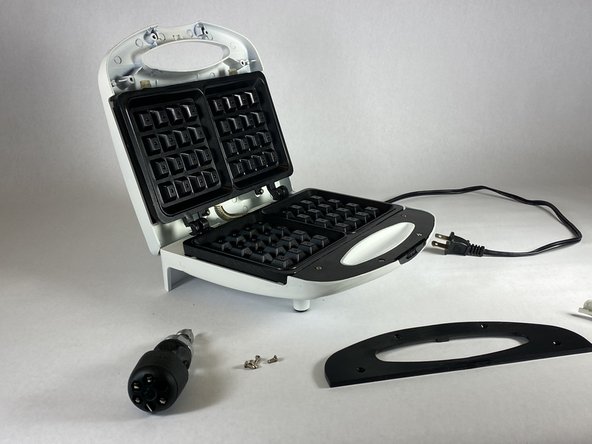

    4. Kitchen Gourmet Waffle Maker Release Latch Spring Replacement: step 4, image 1 of 2 Kitchen Gourmet Waffle Maker Release Latch Spring Replacement: step 4, image 2 of 2
      • Use a Phillips #1 screwdriver to remove the four screws that secure the plastic handle cover.
      • Spin in counterclockwise direction to loosen.

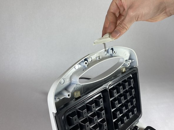

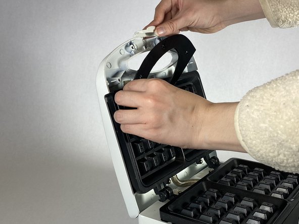

    5. Kitchen Gourmet Waffle Maker Release Latch Spring Replacement: step 5, image 1 of 3 Kitchen Gourmet Waffle Maker Release Latch Spring Replacement: step 5, image 2 of 3 Kitchen Gourmet Waffle Maker Release Latch Spring Replacement: step 5, image 3 of 3
      • Carefully pull back the plastic cover, and gently remove the release latch.

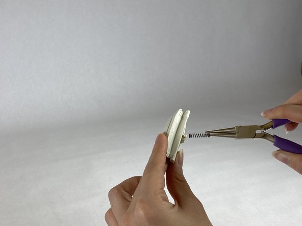

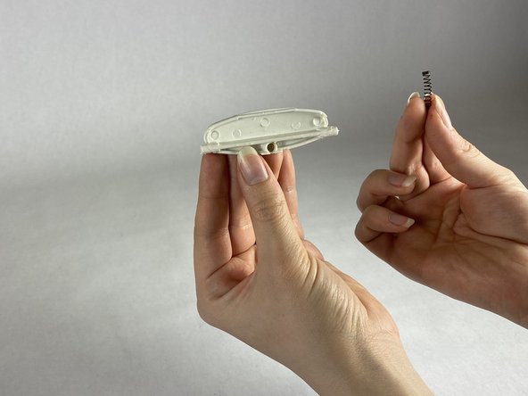

    6. Kitchen Gourmet Waffle Maker Release Latch Spring Replacement: step 6, image 1 of 2 Kitchen Gourmet Waffle Maker Release Latch Spring Replacement: step 6, image 2 of 2
      • Remove the spring from the latch.

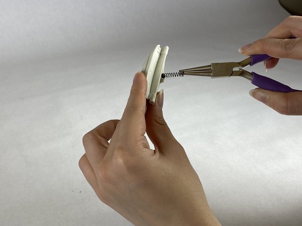

    7. Kitchen Gourmet Waffle Maker Release Latch Spring Replacement: step 7, image 1 of 3 Kitchen Gourmet Waffle Maker Release Latch Spring Replacement: step 7, image 2 of 3 Kitchen Gourmet Waffle Maker Release Latch Spring Replacement: step 7, image 3 of 3
      • Carefully replace with the new spring.
      • Pliers are recommended but removal with hands is fine.
      • Be careful not to bend the spring when pushing into the plastic handle.

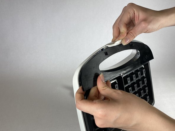

    8. Kitchen Gourmet Waffle Maker Release Latch Spring Replacement: step 8, image 1 of 3 Kitchen Gourmet Waffle Maker Release Latch Spring Replacement: step 8, image 2 of 3 Kitchen Gourmet Waffle Maker Release Latch Spring Replacement: step 8, image 3 of 3
      • Orient the release latch in the correct direction, and line up the spring.
