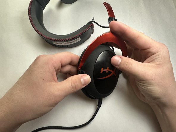

  1. Kingston HyperX Cloud II Speaker Wire Repair, Kingston HyperX Cloud II Speaker Wire Repair: step 1, image 1 of 1
    • Pulling along the edges, take off the ear padding.
