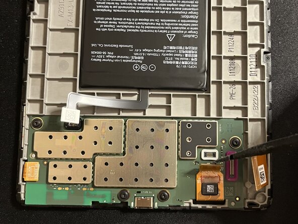

    5. Kindle Paperwhite 11th Generation Disassembly, Disconnect Cables: step 5, image 1 of 2 Kindle Paperwhite 11th Generation Disassembly, Disconnect Cables: step 5, image 2 of 2
      • Carefully lift all ribbon cables from the board. Plastic or metal spudger works best. Use ESD safe tools.

    6. Kindle Paperwhite 11th Generation Disassembly, Continue Disconnect Cables: step 6, image 1 of 2 Kindle Paperwhite 11th Generation Disassembly, Continue Disconnect Cables: step 6, image 2 of 2
      • While lifting next ribbon cable, take note the lower portion appears to be glued down, exercise caution.

    7. Kindle Paperwhite 11th Generation Disassembly, Continue Disconnect Cables: step 7, image 1 of 2 Kindle Paperwhite 11th Generation Disassembly, Continue Disconnect Cables: step 7, image 2 of 2
      • Lift last ribbon cable.

Amazing. Thank you! I see my screen data ribbon is missing a pin (it snapped off) but I still have it. Not sure i can fix it but perhaps can get a new ribbon. Do you know the part number?
James Paxton - Reply Share
sorry I cannot locate that, but perhaps another contributor can. best source is likely ebay...
mcvtech - Reply Share

looks like the battery is stuck. Did you manage to remove it (I need to change the eink screen) ?
richard roberts - Reply Share
