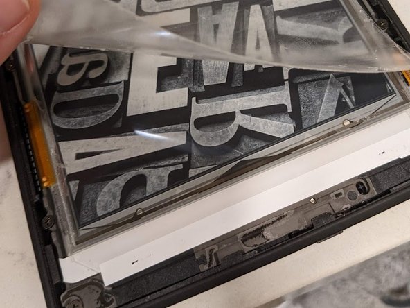

    3. Kindle PW2 fix screen scratch (replace screen surface layer/ light guide Replacement), Peel off the light guide: step 3, image 1 of 3 Kindle PW2 fix screen scratch (replace screen surface layer/ light guide Replacement), Peel off the light guide: step 3, image 2 of 3 Kindle PW2 fix screen scratch (replace screen surface layer/ light guide Replacement), Peel off the light guide: step 3, image 3 of 3
      • Start to peel off from any of the 4 corners. Just be careful not to scratch the touch screen, which is the glossy surface under this plastic light guide.
      • *Feedback from other fixers: suggest to peel from the top corner, as the bottom corner is close to the backlight and it can be accidentally damaged.

      • This is the peeled off light guide. which is an anti-glare layer.
      • It has a thin sticky layer at the back to stick to the touch screen

      • After peeling off the original light guide, replace with any common anti-glare PET screen protector
      • You may get a matt screen guard designed for kindle. But this one I got lower the resolution of the screen, i.e. the text became less clear.
      • I then tried another anti-glare iPad PET screen protector. Cut it into Kindle's size. This one does not lower the resolution, but the anti-glare effect is not as good as the original light guide.

Does the light work with the non original light guide layer?
Cyberman - Reply Share
Yes the backlight will still work, 100%, no worries.
