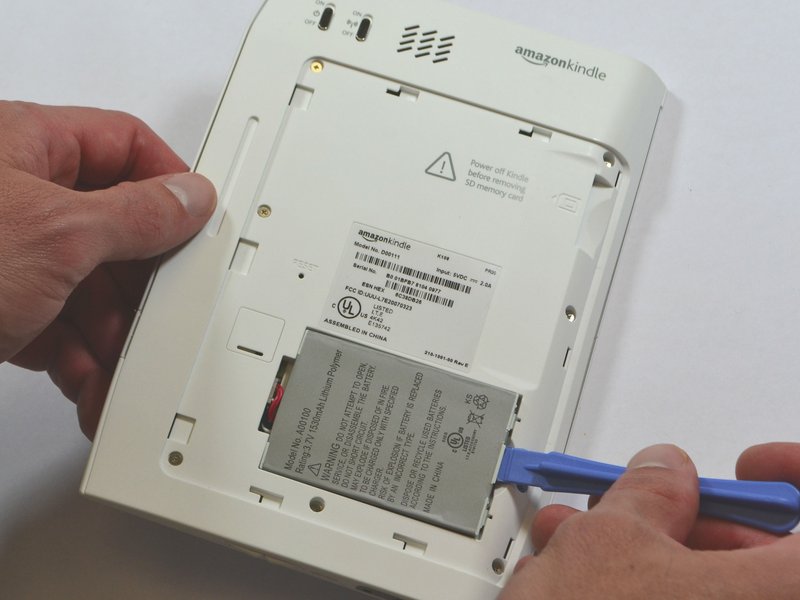

      • Slide the grey plastic cover laterally off the back of the device.
      Ask FixBot
    2. Kindle 1st Generation Battery Replacement: step 2, image 1 of 2 Kindle 1st Generation Battery Replacement: step 2, image 2 of 2
      • Use a plastic opening tool to lift the battery on the side closest to the edge of the device.
      • Unplug the battery from the device by pinching the white connector and pulling.
      • Do not yank the battery or try to disconnect the battery by pulling the wires.
