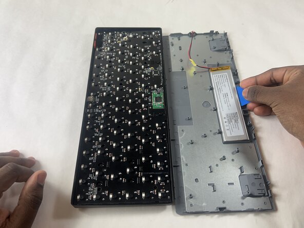

    6. Keychron K3 V2 Battery Replacement: step 8, image 1 of 2 Keychron K3 V2 Battery Replacement: step 8, image 2 of 2
      • Using a slow sawing motion, use an opening pick underneath the battery to lift it.
      • Avoid metal tools, as they can cause damage to the battery.
      • (Optional) You can use a hairdryer to heat up the adhesive, making it easier to take the battery off.
