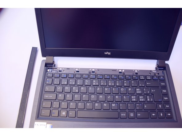

    1. Keyboard replacement, Keyboard: step 2, image 1 of 3 Keyboard replacement, Keyboard: step 2, image 2 of 3 Keyboard replacement, Keyboard: step 2, image 3 of 3
      • Gently press on the first clips to remove the cover strip with the ON / OFF button.
      • Gently press on the second clips to remove the cover strip with the ON / OFF button.
      • And so on.
      Ask FixBot
    2. Keyboard replacement: step 3, image 1 of 3 Keyboard replacement: step 3, image 2 of 3 Keyboard replacement: step 3, image 3 of 3
      • Then flip the laptop over and free the cover strip.
      • The four keyboard fixing screws are now visible.
      • Now loosen these fixing screws.
      Ask FixBot
