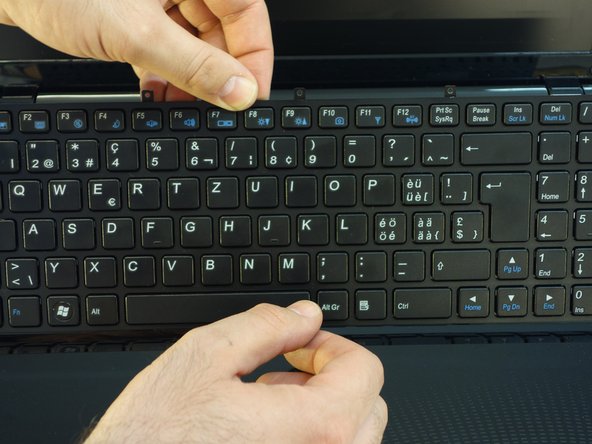

    2. Keyboard replacement on a why! W253EU: step 3, image 1 of 3 Keyboard replacement on a why! W253EU: step 3, image 2 of 3 Keyboard replacement on a why! W253EU: step 3, image 3 of 3
      • Use a Phillips # 1 screwdriver to remove the four screws securing the keyboard in the upper part.
      Ask FixBot
    3. Keyboard replacement on a why! W253EU: step 4, image 1 of 2 Keyboard replacement on a why! W253EU: step 4, image 2 of 2
      • Turn the keyboard towards the screen.
      • Carefully remove the connection cable in the direction of the plug axis.
