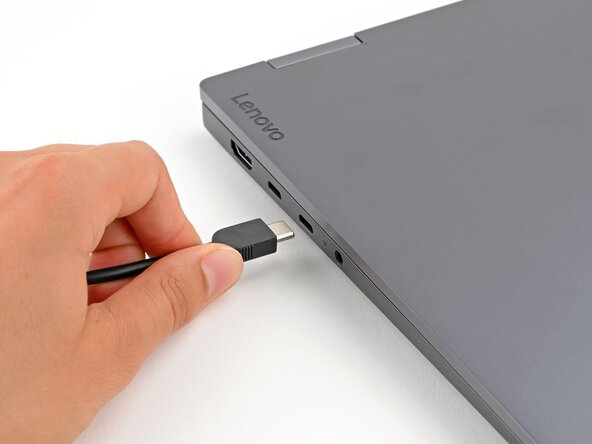

    1. Keyboard Assembly Removal, Prepare your laptop for disassembly: step 1, image 1 of 3 Keyboard Assembly Removal, Prepare your laptop for disassembly: step 1, image 2 of 3 Keyboard Assembly Removal, Prepare your laptop for disassembly: step 1, image 3 of 3
      • For your safety, discharge your battery below 25% before disassembling your laptop. A charged battery may catch fire if damaged.
      • Fully shut down your laptop and unplug all cables.
      • Remove the stylus from the case.
      Ask FixBot

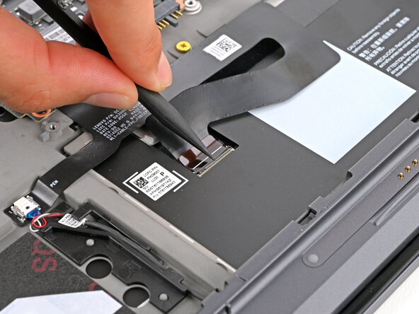

    1. Keyboard Assembly Removal, Disconnect the USB IO board: step 7, image 1 of 3 Keyboard Assembly Removal, Disconnect the USB IO board: step 7, image 2 of 3 Keyboard Assembly Removal, Disconnect the USB IO board: step 7, image 3 of 3
      • Use the point of a spudger or a clean fingernail to lift the small locking flap on the fingerprint reader connector.
      • Use a pair of tweezers to slide the fingerprint reader cable out of its connector.
      • Grip the cable by its plastic pull tab, not the cable itself.
      Ask FixBot
