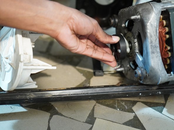

  9. Kenmore 90 Series Washing Machine Drive Motor Coupling Replacement: step 9, image 1 of 3 Kenmore 90 Series Washing Machine Drive Motor Coupling Replacement: step 9, image 2 of 3 Kenmore 90 Series Washing Machine Drive Motor Coupling Replacement: step 9, image 3 of 3
    • Place the drive motor to the side and remove the direct drive coupler by sliding it off.

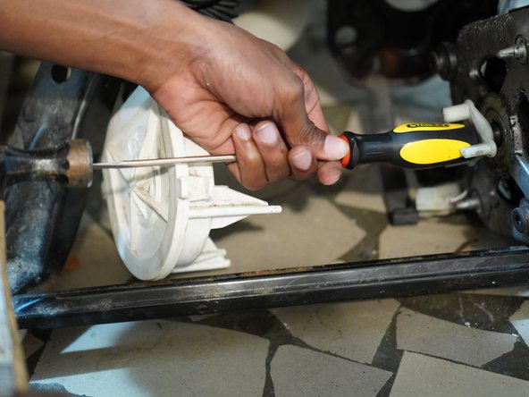

  10. Kenmore 90 Series Washing Machine Drive Motor Coupling Replacement: step 10, image 1 of 2 Kenmore 90 Series Washing Machine Drive Motor Coupling Replacement: step 10, image 2 of 2
    • Replace with the new direct drive coupler and use the end of your screwdriver to seat it flush on the drive motor.
