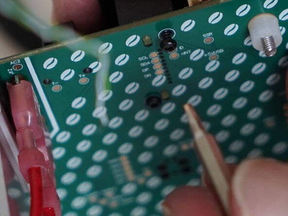

  11. Kaffelogic Nano 7/LINK (D-P Serial) USB Daughterboard Replacement, Remove PCB screws: step 11, image 1 of 1
    • Unscrew the 4x PH2 PCB screws.
    • These screws are captive to the PCB.
  12. Kaffelogic Nano 7/LINK (D-P Serial) USB Daughterboard Replacement, Remove the PCB: step 12, image 1 of 3 Kaffelogic Nano 7/LINK (D-P Serial) USB Daughterboard Replacement, Remove the PCB: step 12, image 2 of 3 Kaffelogic Nano 7/LINK (D-P Serial) USB Daughterboard Replacement, Remove the PCB: step 12, image 3 of 3
    • Pull the PCB away from the base assembly.
    • Use pliers to disconnect the transformer secondary wires from the back of the PCB
    • The transformer wires may be reconnected in either orientation. If you are replacing the USB daughterboard, you can choose to leave these wires in place.

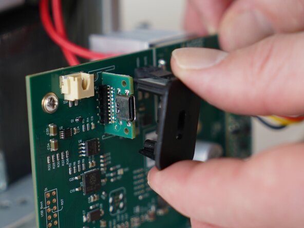

  14. Kaffelogic Nano 7/LINK (D-P Serial) USB Daughterboard Replacement, Remove shroud: step 14, image 1 of 1
    • Slide the plastic shroud away from the PCB

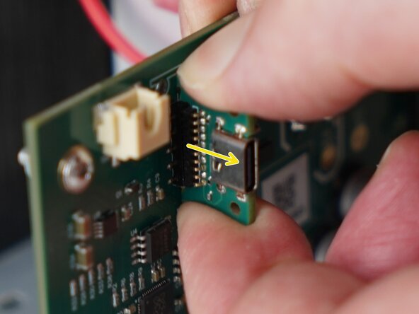

  15. Kaffelogic Nano 7/LINK (D-P Serial) USB Daughterboard Replacement, Remove the daughterboard: step 15, image 1 of 2 Kaffelogic Nano 7/LINK (D-P Serial) USB Daughterboard Replacement, Remove the daughterboard: step 15, image 2 of 2
    • Pull away on the daughterboard to remove it from the main PCB.
