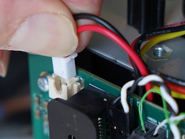

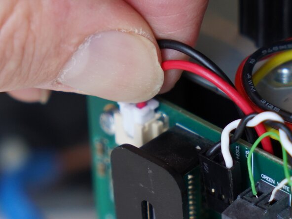

  6. Kaffelogic Nano 7/LINK (A/B/C-N Serial) SSR Replacement, Disconnect gantry cables: step 6, image 1 of 3 Kaffelogic Nano 7/LINK (A/B/C-N Serial) SSR Replacement, Disconnect gantry cables: step 6, image 2 of 3 Kaffelogic Nano 7/LINK (A/B/C-N Serial) SSR Replacement, Disconnect gantry cables: step 6, image 3 of 3
    • Disconnect the SSR signal lead and motor from the PCB-A

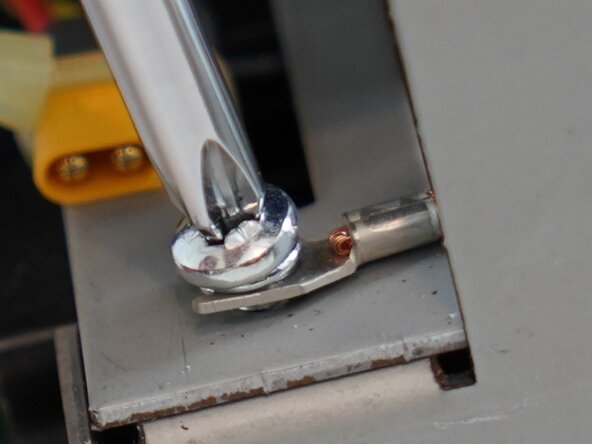

  7. Kaffelogic Nano 7/LINK (A/B/C-N Serial) SSR Replacement, Remove gantry screws: step 7, image 1 of 3 Kaffelogic Nano 7/LINK (A/B/C-N Serial) SSR Replacement, Remove gantry screws: step 7, image 2 of 3 Kaffelogic Nano 7/LINK (A/B/C-N Serial) SSR Replacement, Remove gantry screws: step 7, image 3 of 3
    • Remove the 4x PH2 screws securing the gantry plate to the base.
    • Be sure to place the earth spade under the screw head when reassembling.

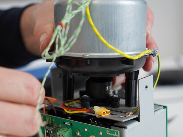

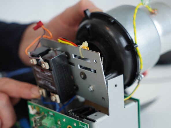

  8. Kaffelogic Nano 7/LINK (A/B/C-N Serial) SSR Replacement, Lift the stack: step 8, image 1 of 3 Kaffelogic Nano 7/LINK (A/B/C-N Serial) SSR Replacement, Lift the stack: step 8, image 2 of 3 Kaffelogic Nano 7/LINK (A/B/C-N Serial) SSR Replacement, Lift the stack: step 8, image 3 of 3
    • Tip the stack forward to gain access to the SSR.

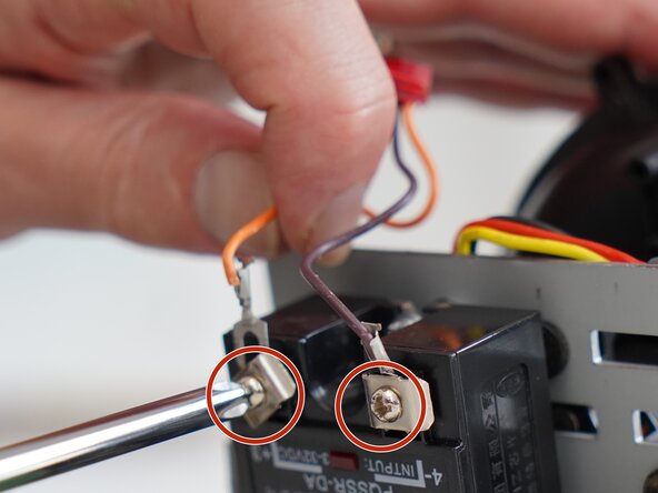

  9. Kaffelogic Nano 7/LINK (A/B/C-N Serial) SSR Replacement, Remove trigger lead: step 9, image 1 of 2 Kaffelogic Nano 7/LINK (A/B/C-N Serial) SSR Replacement, Remove trigger lead: step 9, image 2 of 2
    • Use a PH2 screwdriver to remove the trigger lead.
    • Note that this connection is polarized. Connect red/orange to (+) and black/brown to (-) markers on the SSR.

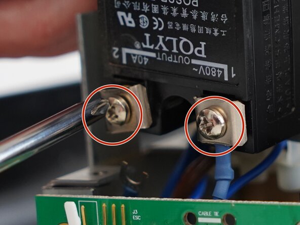

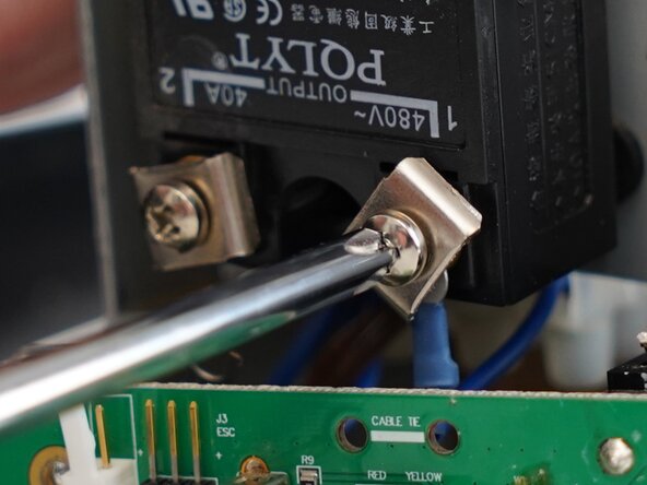

  10. Kaffelogic Nano 7/LINK (A/B/C-N Serial) SSR Replacement, Remove the mains wiring: step 10, image 1 of 2 Kaffelogic Nano 7/LINK (A/B/C-N Serial) SSR Replacement, Remove the mains wiring: step 10, image 2 of 2
    • Use a PH2 screwdriver to remove the two mains spade terminals.

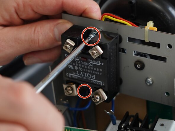

  11. Kaffelogic Nano 7/LINK (A/B/C-N Serial) SSR Replacement, Remove the SSR screws: step 11, image 1 of 2 Kaffelogic Nano 7/LINK (A/B/C-N Serial) SSR Replacement, Remove the SSR screws: step 11, image 2 of 2
    • Remove the 2x PH2 screws securing the SSR to the bottom of the gantry plate.
