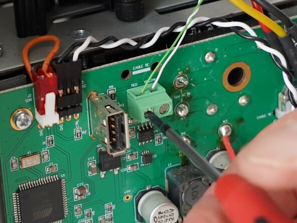

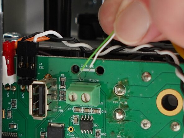

  6. Kaffelogic Nano 7/LINK (A/B/C-N Serial) Roast Chamber Replacement, Disconnect the thermocouple: step 6, image 1 of 3 Kaffelogic Nano 7/LINK (A/B/C-N Serial) Roast Chamber Replacement, Disconnect the thermocouple: step 6, image 2 of 3 Kaffelogic Nano 7/LINK (A/B/C-N Serial) Roast Chamber Replacement, Disconnect the thermocouple: step 6, image 3 of 3
    • Use a 2.0mm slotted screwdriver to remove the thermocouple wires from the PCB-A

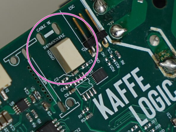

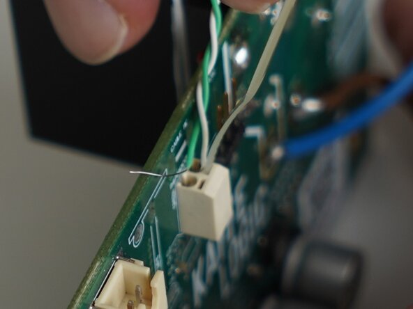

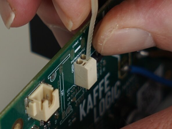

  7. Kaffelogic Nano 7/LINK (A/B/C-N Serial) Roast Chamber Replacement, White thermocouple connector: step 7, image 1 of 3 Kaffelogic Nano 7/LINK (A/B/C-N Serial) Roast Chamber Replacement, White thermocouple connector: step 7, image 2 of 3 Kaffelogic Nano 7/LINK (A/B/C-N Serial) Roast Chamber Replacement, White thermocouple connector: step 7, image 3 of 3
    • If your thermocouple connector looks like this, you will need to follow this step.
    • Use the end of a cable tie or very small plastic spudger to open the contact and remove/insert your thermocouple wires. You may need to trim the cable tie end to fit into the slot.

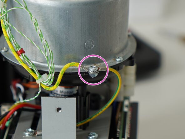

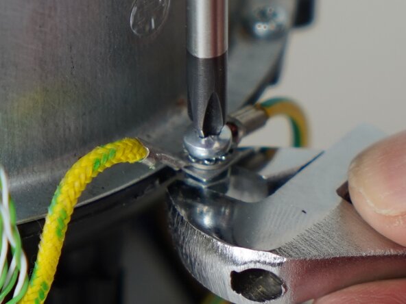

  8. Kaffelogic Nano 7/LINK (A/B/C-N Serial) Roast Chamber Replacement, Disconnect the roast chamber earth: step 8, image 1 of 3 Kaffelogic Nano 7/LINK (A/B/C-N Serial) Roast Chamber Replacement, Disconnect the roast chamber earth: step 8, image 2 of 3 Kaffelogic Nano 7/LINK (A/B/C-N Serial) Roast Chamber Replacement, Disconnect the roast chamber earth: step 8, image 3 of 3
    • Use a PH2 screwdriver and adjustable crescent (or 5.5mm wrench) to remove the screw holding the earth leads to the element chamber.
