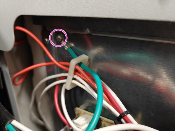

    4. June Oven Overheating Screen Fix, Remove wires connected to power cable.: step 4, image 1 of 3 June Oven Overheating Screen Fix, Remove wires connected to power cable.: step 4, image 2 of 3 June Oven Overheating Screen Fix, Remove wires connected to power cable.: step 4, image 3 of 3
      • The white and black wires essentially just slot onto pegs. Get a good grip on the side to pull them free.
      • The green cable is screwed into the chassis. Should be the same sized screw as all the ones in the base.

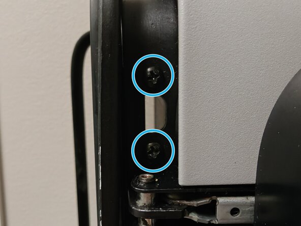

    6. June Oven Overheating Screen Fix, Remove screws attaching the hinge.: step 6, image 1 of 1
      • 2 sets of 2 screws by each hinge. These have rounded heads, make sure to separate them from the screws you remove in step 7.

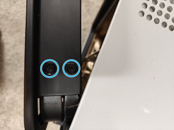

    7. June Oven Overheating Screen Fix, Remove screws holding in internal glass.: step 7, image 1 of 2 June Oven Overheating Screen Fix, Remove screws holding in internal glass.: step 7, image 2 of 2
      • 2 sets of 2 screws each side. I believe they are the same length but make sure just in case. These have flat tops, separate from the round topped screws from step 6.
      • Once these are removed you should be able to bend the hinge slightly and remove the full front glass & screen assembly. Make sure the cables for the screen dont snag on anything while you do this.

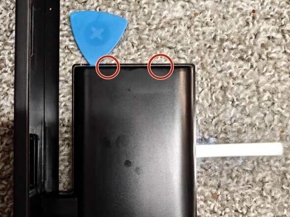

    9. June Oven Overheating Screen Fix, Pry open the plastic screen covering.: step 9, image 1 of 2 June Oven Overheating Screen Fix, Pry open the plastic screen covering.: step 9, image 2 of 2
      • There are 2 clips on the top and bottom, located roughly where circled. Use a spudger or pick to release them.

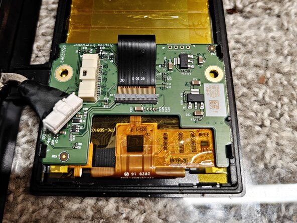

    10. June Oven Overheating Screen Fix, Remove connector from daughter board.: step 10, image 1 of 2 June Oven Overheating Screen Fix, Remove connector from daughter board.: step 10, image 2 of 2
      • Remove the connector using the same technique you did for the green connector in step 5.
      Ask FixBot
    11. June Oven Overheating Screen Fix, Remove ribbon cables from daughter board.: step 11, image 1 of 2 June Oven Overheating Screen Fix, Remove ribbon cables from daughter board.: step 11, image 2 of 2
      • Use a spudger to gently lift the locks on both connectors then remove the ribbon.
      Ask FixBot
    12. June Oven Overheating Screen Fix, Remove daughter board.: step 12, image 1 of 1
      • The daughter board is held in by 4 clips, press back the clips gently one side at a time to move the daughter board out of the way.

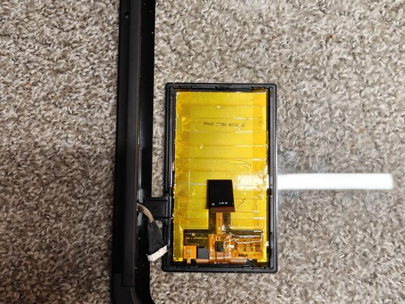

    13. June Oven Overheating Screen Fix, Add kapton tape to back of screen.: step 13, image 1 of 2 June Oven Overheating Screen Fix, Add kapton tape to back of screen.: step 13, image 2 of 2
      • Cover the full back of the screen in kapton tape.
      • When taping down the ribbons make sure to not put kapton tape between the orange ribbon and the conductive pad below (unsure if this would cause issues but wouldnt recommend it).
